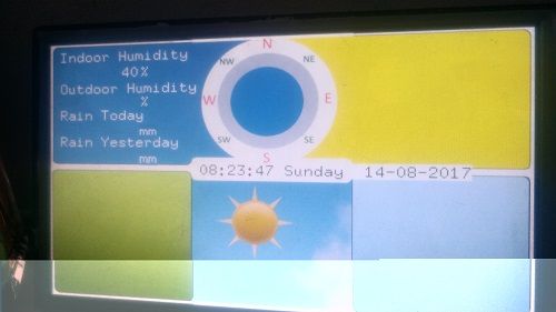

I'm trying to get a "simple" compass drawn on a 7" display
What I need it the ability to rotate the pointer to any one of 360 degree points
The degree points will be ascertained by a wind vane outside.
I'm totally hopeless at writing code as most of you know
I have used Matherps Compass.Bas code as a starting point but this was written for genuine sensors and not just as a simple compass display choosing one of 360 degrees to point to
I am hopeless at maths and I cannot understand most of the code, ie the bits that rotate the triangle
I have got it to display the compass pointer on the screen BUT IT DISPLAYS 2 pointers one above the other????
I know I have no background image btw*
Anyone able to explain in words a 10 yr old could understand how the pointers bit works and how to get it to rotate clockwise to any one of 360 points 0 to 359 degrees with 0 as North
What I need to know is how to make the triangles rotate to one of the 360 positions.
IF anyone would be so kind as to help explain it to me please
This is how i've got this far

Posted: 10:34pm 13 Aug 2017
  Quote  And I've no idea why there are 2 pointers
You are using code designed to run on a 480x272 display with a paged driver on a 800x480 display
The original code swaps between the display pages and only updates the hidden page to remove all flicker
See this thread for documented code showing how to construct and move pointersEdited by matherp 2017-08-15
Thanks Peter, I've got only one pointer now :)
Just reading that post now
