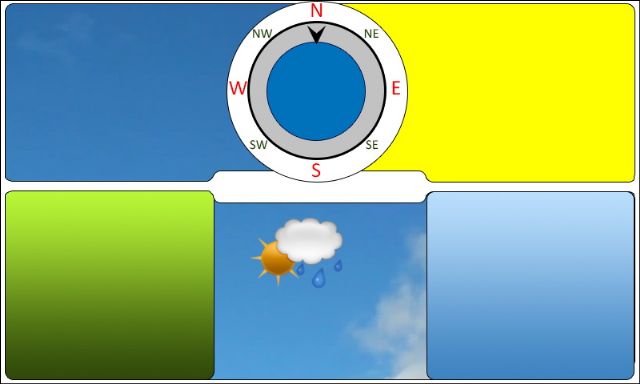

I finally started working on the weather station again tonight, with a nice new look to it and the Big Ben clock is gone.
My brain will not work though (YES I have read both manuals)
How do I simply print the time on the display?
I want to display it in a white box in the middle of the screen and get the time from the RTC
and every night at midnight poll the RTC to get the new date and display both the date and DOW
but my mind is fried,
I know its such a simple command that lots of you are probably laughing but try as hard as I can and I cannot figure it out

but try as hard as I can and I cannot figure out how to display the things on the screen, or how to get the time to update every second and get the new time/date/dow at midnight
I know that Text 290,215, DOW$(DayOfWeek(Year, Month, Day)), CM, 1, 2, RGB(BLACK), RGB(63, 133, 195) works for the day of the week
BUT it will NOT Update and change at midnight or any other time it only stays the same day forever
Such simple things I know
Anyone able to throw some light on this?
Also does anyone have any pictures of what various fonts actually look like?
What I want to do is display the time and ideally date/day on the white box in the middle of the pic - I might need to make the box bigger though or I might need to only put the time there -
I'm using a 7" display and an E100 board
