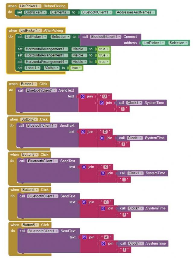

oops! - well spotted
https://m.youtube.com/watch?v=evVRCL9-TWs

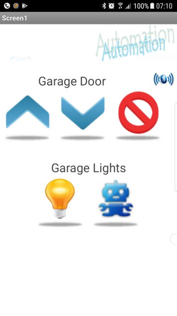

Then processed the strings on the uM. I piggy-backed the uM on the existing controller (don't want to lose or interfere with existing functionality - it must always work the same way it used to). Will post the uM code soon.
I have a look up for daytime in the uk and it will put the external light (over the door) on when the door is opened automatically if it is outside daylight hours for the date. It has no RTC though! I send the unixtime from the android device each time and it will set its clock from that - just in time processing
The light functionality on the app is for the internal light - on or automatic (on PIR sensors)
I never seem to have the plipper with me when I want it but I always have my phone.
