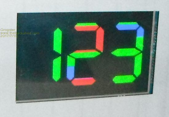

Hello folks.
Has anyone seen this problem before:
This happens on an E100, if I leave the PIC32 clock speed at 120MHz or 100MHz.
As soon as I slow the CPU down to 80MHz or slower, the problem goes away.
This LCD is set for 1963 backlight control, and at 100MHz or 120MHz, the backlight command has no effect at all, neither does CLS.
Throttle-back to 80MHz, and everything works fine.
I don't really care, so long as it works, but exactly how fast is the data clocked to the 1963 LCD's on the MM+ chips? It would appear to be affected by the clock speed, cos if you slow the clock right down, the LCD refresh rate is proportionally slower.
Yes, similar at least. I have a 1963 display that won't work on an E100 if the CPU is running above 80MHz. 80 or below - no problems. From memory the issue I had was that it basically wouldn't display any text or graphics, and the background color would be something other than what I had set and was probably banded - i.e. bands of varying colors (been a while since I looked at it so some of the detail is a little hazy now).

Hi there.
Yes, your description seems to be EXACTLY the same problem I am having here.
Interestingly, I have NEVER seen this issue with 1963 7" LCD's, just the 5" ones, which is really confusing, as apart from a different LCD geometry, the controller chip is exactly the same SSD1963 in both types....
Oh well. I don't really care so long as it works by throttling back a little, but it is curious.
I tried running the PIC32 at 5MHz just for a giggle - boy, that makes for a slow refresh rate!

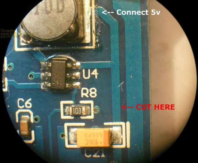

The 5V displays are powered through a single pin at 3.3V whereas the 7" displays have a separate 5V supply for the backlight. Can't find my E100 to check but you really need a beefy connection and good decoupling/bulk capacitance to the power pin for the 5" display.
On one of my 5" displays I cut the track to the backlight boost circuit and powered it from 5V. It is the track on the outer end of C21Edited by matherp 2017-07-19

EDIT: Is this how you do it? I want to be sure before I blow up a perfectly good LCD....

  Quote  EDIT: Is this how you do it?
I cut the other side of C21 to leave it in circuit. It is easy to go back to normal if required by soldering a link across the cut

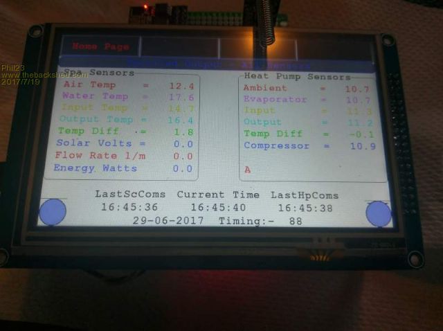

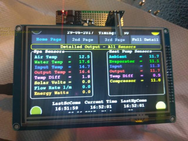

Hi Grog,
Been meaning to make this post, but haven't got there till now.
I have 2 E100 with 5" displays which are fine.
BUT
A friend bought an E100 a few months back & has screen issues.
He bought a second display & still has issues.
His displays appear to fail on my E100's also when we test them.

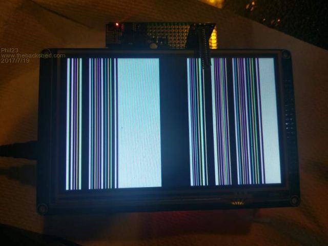

His email to me....
Photos added below, their context in his quote.
[Quote=RF]Some examples of display failure when using TAB 4 of Phil's code
This usually happens within 10 to 15 minutes
In this case the screen registration is down half a line
In this case the colours have changed.
Also we quite often get flickering incorrect chars on the screen.
This was on Phil's hardware using two separate screens. Both these screens appear to be slightly different to Phil's screens (which work fine)
Any clues or ideas appreciated. I bought the second screen when the first screen gave trouble. So I now potentially have two bad screens (or two slightly different screens) . They seem fine until they are pushed by the high update rate of Phil's TAB 4.
Thanks in advance[/quote]
All these examples are RF's displays on my E100.

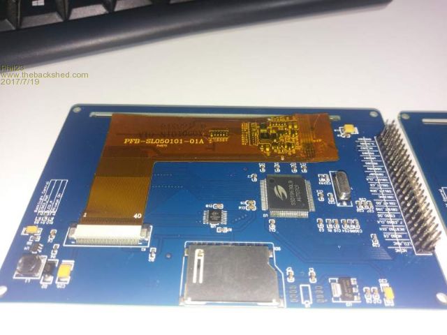

The last image shows the part number on the ribbon cable which is different to mine.
Both mine have V2 in the number near the end, but I don't have them on hand.
Phil.

I have mainly the 2A LCD's, but I also have 01A LCD(I've just looked), so I will plug the 01A into a working E100 and see if I get the same result. I don't think it should matter, as that number is only for the LCD matrix thing-y, the 1963 controller chip is the same across all these displays, so they should ALL work in an ideal world.
Please ask them to SLOW DOWN the CPU to no more then 80MHz just to see if the problem clears, also do the 5v mod that matherp recommends to see if that helps.
