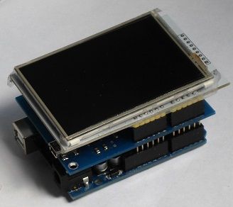

I have been trialling using a lcd for a while. The intent is for a small display
for user on-going info and simple control via selections etc.
[The background idea was, to separate the display/presentation tasks from the main processing, but to keep the information/context on the screen tightly bound with the machine state changes and user control - well that is the excuse. ]
A simple protocol is all that is needed, I used SPI (that is, serial peripheral interface, not espionage ) and it is working OK. So, a client display hangs off the main pcb on a spi port and has data sent to it, and sends back the user selections etc as they are made.
In this case the main board is a pic32mx170 running a simple A/D acquisition on two pins, corresponding to say voltage and current measurements. (A "burst" A-D mode can be used for much faster data acquisition, or say a pic32MZ instead obviously).

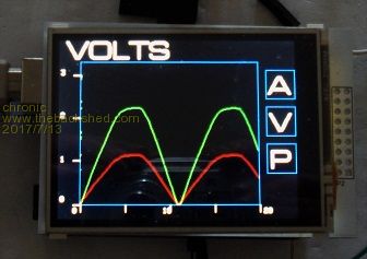

The user can select option A,V,P (amps, voltage,power) on the touchscreen and the
choice is sent back to the main program. This alters the program flow accordingly. So, if "P" (power) is selected, instead of the volt and amp values being sent, the program multiplies the two data points
(amps, volts) to give the power value, and the result is scaled and sent.

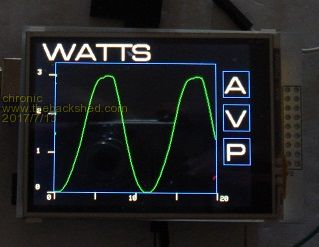

DO WHILE ( i < 121 )
val = FLOAT ( dat(i,1) ) * sclfac
val = FLOAT ( dat(i,2) ) * sclfac * val
val = val * 0.02
mm = IFIX val + 32
and the display now shows the power instead

Although GUI/Net-world has controls and scripts eg for user i/o handling, there does not seem to be a simple standard protocol established for micros, for displaying a small meter or gauge and updating it, that would make these things more transferable (?) and separable. It would make development easier I think.
So as a very provisional start, here is what working so far -

// uses standard font, and the input buffer
// is filled using adc values instead of using spi transfer
// from other systems
// Requires 240x320 lcd (parallel connect)
// and the Adafruit libraries as per lcd,
// the Adafruit LCD advisory is used
// Initial part of trace is left on screen as visual history
// Assumes 5v rail is actually 5v as reference so
// measurement accuracy depends on that, unlikely to
// be better than a percent or so.
// Supplied for demonstration only. Use at own risk. Do not use
// in situations where any hazard, damage, or liability may occur.
// Stuart Oliver, Oct/Nov 2017

strcpy(obj4.newtxt, "b" );
strcpy(obj4.oldtxt, "b" );
strcpy(obj5.newtxt, "c" );
strcpy(obj5.oldtxt, "c" );
strcpy(obj6.newtxt, "d" );
strcpy(obj6.oldtxt, "d" );
tft.setTextColor(WHITE);
for ( numobj = 0; numobj < maxobj; numobj ++ )
if (screen[numobj].flags.visible == 1)
if (screen[numobj].obtype == 1) // 1 = text
tft.setCursor(screen[numobj].xloc, screen[numobj].yloc);
tft.println(screen[numobj].oldtxt);
else if (screen[numobj].obtype == 2) // 2 = button
tft.setCursor(screen[numobj].xloc + 6, screen[numobj].yloc - 10);
return;
void updatescreen() {
byte nxtchr = 0;
byte linenum = 1 ;
if ((screen[numobj].flags.repaint != 0)
&& (screen[numobj].flags.visible == 1))
if (screen[numobj].obtype == 1) // 1 = alphanumeric field
if ( strcmp (screen[numobj].oldtxt, screen[numobj].newtxt) != 0 )
nxtchr = 0;
while ( screen[numobj].oldtxt[nxtchr] ==
screen[numobj].newtxt[nxtchr] )
tft.print(screen[numobj].oldtxt[nxtchr]);
nxtchr ++ ;
tft.setTextColor(BLACK);
while ( screen[numobj].oldtxt[nxtchr] != '\0' )
nxtchr ++ ;
tft.println(screen[numobj].newtxt);
strcpy(screen[numobj].oldtxt, screen[numobj].newtxt);
if (screen[numobj].flags.enabled == 1)
objboilerplate ( numobj );
tft.print(screen[numobj].newtxt);
else if (screen[numobj].flags.enabled == 0)
{ tft.drawRoundRect(screen[numobj].xloc,
(screen[numobj].yloc - screen[numobj].ysize),
screen[numobj].xsize, screen[numobj].ysize, 8 , GREEN );
tft.setTextColor(DIM);
screen[numobj].flags.repaint == 0 ;
else if (screen[numobj].obtype == 3) // 3 text block (/menu)
nxtchr = 0;
tft.setFont();
// tft.setFont(µgmm18pt7b);
tft.setFont(&FreeSans12pt7b);
tft.fillRect(screen[numobj].xloc + 1,
(screen[numobj].yloc - screen[numobj].ysize + 1),
screen[numobj].xsize - 2, screen[numobj].ysize - 2, BLACK );
screen[(linenum ++ + 1)].yloc - 10);
while ( nxtchr < count )
tempchar = stage[nxtchr];
if (tempchar == 13)
if ( screen[numobj].flags.text == 1 )
+ linenum ++ * 28);
else // menu vertical
else
tft.print(tempchar);
nxtchr ++ ;
objboilerplate(numobj);
tft.setFont(&FreeSans18pt7b);
else if (screen[numobj].obtype == 4) // 4 text block (menu)
nxtchr = 0;
//tft.setFont();
if (tempchar == 13)
else
nxtchr ++ ;
//tft.setFont(µgmm18pt7b);
// tft.setFont(&FreeSans12pt7b);
else if (screen[numobj].obtype == 5) // 5 = sweep
yl = atof(screen[numobj].newtxt) / 3.3 * 180 ;
rx = 31 + j ;
ry = 222 - yl ;
darkry = dark[j];
if ( j == 0 ) {
oldrx = 31 ;
oldry = ry ;
darkry = ry ;
darkoldry = ry ;
tft.drawLine(oldrx, darkoldry, rx, darkry, BLACK);
// tft.drawLine(oldrx, oldry, rx, ry, RED//);
tft.drawLine(oldrx, oldry, rx, ry, GREEN);
oldrx = rx ;
oldry = ry ;
dark[j] = ry ;
darkoldry = darkry ;
j++ ;
if (j == 239 )
j = 0 ;
else if (screen[numobj].obtype == 6) // 6 = trace
j = 0 ;
nxtchr = 0 ;
yl = stage[nxtchr] - 32;
rx = 30 + j * 2 ;
ry = 222 - yl ;
// if (ry > 200 ) ry = 220 ;
darkry = dark[j];
if ( j == 0 ) {
oldrx = 30 ;
oldry = ry ;
darkry = ry ;
darkoldry = ry ;
if (nthtrace > 0 ) {
oldrx = rx ;
oldry = ry ;
dark[j] = ry ;
j++ ;
if (j == 120 )
j = 0 ;
nthtrace ++ ;
nxtchr ++ ;
screen[numobj].flags.repaint = 0 ;
nthrecin = 0;
//memset(stage, '\0', 120);
return ;
void act_stateA() {
return ;
void act_stateB() {
return ;
void act_stateC() {
return ;
void act_stateD() {
return ;
void boilerplate() {
byte numobj ;
tft.fillScreen(BLACK);
//outlines
if ( screen[numobj].obtype == 2 )
if ( screen[numobj].obtype == 3 )
tft.drawRect(screen[numobj].xloc,
screen[numobj].xsize, screen[numobj].ysize, RED );
if ( screen[numobj].obtype == 5 )
screen[numobj].xsize, screen[numobj].ysize, BLUE );
// tft.drawLine(31, 223, 31, 40, BLACK);
axetics();
if ( screen[numobj].obtype == 6 )
axetics();
return ;
void objboilerplate ( byte nthob )
if (screen[nthob].flags.visible == 1)
if ( screen[nthob].obtype == 2 )
tft.drawRoundRect(screen[nthob].xloc,
(screen[nthob].yloc - screen[nthob].ysize),
screen[nthob].xsize, screen[nthob].ysize, 8 , GREEN );
if ( screen[nthob].obtype == 3 )
tft.drawRect(screen[nthob].xloc,
screen[nthob].xsize, screen[nthob].ysize, DIM );
if ( screen[nthob].obtype == 5 )
screen[nthob].xsize, screen[nthob].ysize, BLUE );
//tft.drawLine(31, 223, 31, 40, BLACK);
axetics();
if ( screen[nthob].obtype == 6 )
axetics();
void axetics () {
// vert axis tics
tft.drawLine(20, 222, 30, 222, WHITE);
tft.drawLine(20, 167, 30, 167, WHITE);
tft.drawLine(20, 113, 30, 113, WHITE);
tft.drawLine(20, 59, 30, 59, WHITE);
//hori tics
tft.drawLine(30, 223, 30, 230, WHITE);
tft.drawLine(90, 223, 90, 230, WHITE);
tft.drawLine(150, 223, 150, 230, WHITE);
tft.drawLine(210, 223, 210, 230, WHITE);
tft.drawLine(270, 223, 270, 230, WHITE);
// tft.print("0", 20, 225);
// tft.print("10", 140, 225);
// tft.print("20", 260, 225);
// tft.print("ms", 275, 215);
tft.setFont();
tft.setCursor(3, 210);
tft.print("0");
tft.setCursor(3, 155);
tft.print("1");
tft.setCursor(3, 100);
tft.print("2");
tft.setCursor(3, 45);
tft.print("3");
return;

The self-running example runs with just the arduino / genuino uno and parallel drive lcd shield.
The lcd shields are cheap on the net. Adafruit originally had a parallel drive lcd shield version but changed it to back to serial, I used one from Jaycar ie
parallel lcd
which has the blurb and libraries etc as well
Edit - [ example was on arduino v 1.8.3 ]Edited by chronic 2017-12-17

  chronic said   The self-running example runs with just the arduino / genuino uno and parallel drive lcd shield.
parallel lcd
I got 5 of those from ebay reseller (total 28$ AUD) and they work great with My ARDUINO compatibles (Not the WEMOS D1, not enough IO pins). Even works with the Arduino MEGA2560 which is great as they have still lots of spare IO. I am experimenting with making them a slave I2C unit for remote displays. The LCD + UNO costs less than $10 in total making for a cheap remote display. I would/could use with a Micromite/Maximite or even the many Duinomites I own (pinout is compatible with the shield) , but the code library is off-the shelf for the LCD on the arduino. cFunctions in MMbasic is just TOO DAMN convoluted for anything more than a simple function. C/C++ coding is a joy on the Arduino. I even have one of those IL1341 .96inch OLED displays connected to a BareBones ATMEGA328P Chip (<$2) running with internal 8Mhz clock and NO external components.
Edited by djuqa 2017-12-27
