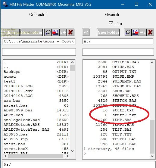

Posted: 09:18pm 10 Jul 2017
Only one way to see;
  Quote   OPEN "stuff2.txt" FOR OUTPUT AS #1
PRINT #1, "line 1"
' something in here screws up and it crashes
PAUSE 200
x = y/
0
PRINT #1, "line 2"
CLOSE #1
The data probably gets written to file progressively but without closing, not good.
For the best security, close then reopen frequently.
Even reopening an existing file to append might be risky.
