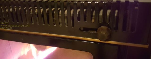

Looking for something to move the air damper on my wood heater.
Something like this with plus 30kg cm torque should be more than sufficient to move the lever the 60mm max from open to closed, but can I drive it with a Micromite?
I'd assume that it would need 6V with sufficient current, but is the control output from the MM just then fed via Gnd & the input signal wire?
40kg Servo.
Other thing I need to contemplate is "Manual Override",
IE, dealing with people walking up & moving the damper manually.
How do I run it so the servo moves the lever, but onces it's positioned, does not fight against any manual movement.
IE cutting power would stop it fighting, but can that be done by deactivating the control output in software after movements have been made?
Phil.

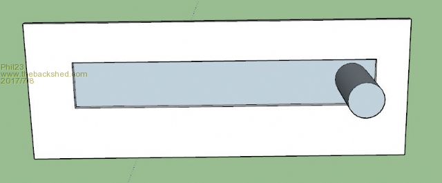

Not sure about a clutch, it did cross my mind, but I have the constraints of space, and need to be conscious of the heat; it can be over 200°C.
I'm thinking it needs to be cable operated, like a motorcycle clutch cable, but temperature resistant.
The damper lever has a travel of just under 50mm from opened to closed.
Thinking I might be able to fit a slotted plate behind the front casing with a 50mm slot and the plate having 100mm of linear travel.
The servo could park the plate in the central position, so that users were free to slam the lever left or right as they please.
The servo could then move to either extreme to either fully open or close in a single operation, then the actuator parked again.
Setting it to intermediate positions would need to be made starting from either a fully opened or closed position, followed by parking the plate again.
I'd presume changes to the damper position would only be made every 5 minutes of so & less overnight.

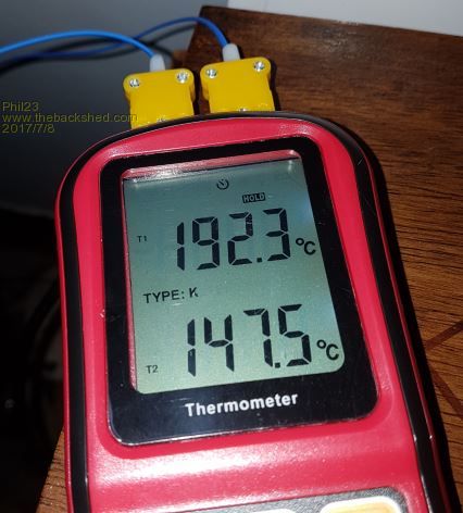

So far I've only monitored temperatures with a couple of K-Type thermocouples, but have 2 thermocouple modules that will screw in somewhere.
Just haven't decided where yet.

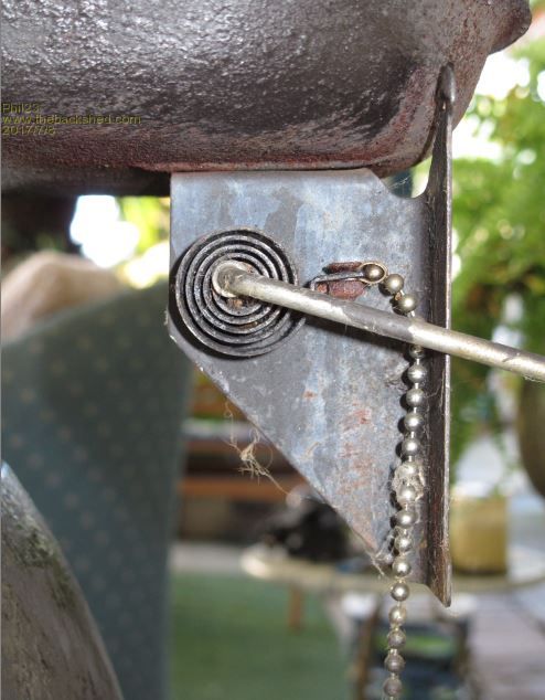

Inspiration comes from the old Pot Belly stove I replaced in the outdoor are a couple of years ago.
It had a very simple & effective thermostatic damper control, which both of the current heaters lack.
Pictures Below; (Not that good at SketchUp, first encounter with it).
Phil.

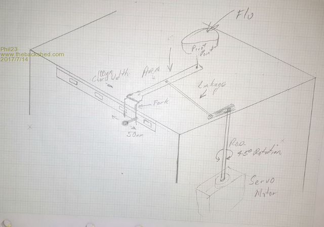

Can' use drawing software for Sh^!...
Does this seem like a good solution though?
Think the Flu needs an "E".
Phil.

Did consider linear actuators, but have the installation constraints & need to avoid the heat.
One issue is that the enameled casing around the firebox can't be removed.
There are two sections on the top that lift off, but removing the front & side sections would require the flue to be removed & the whole thing probably pulled forward.
Plenty of room between the fire box & the casing though, with about 40mm at the top & front & 70mm down this sides.
