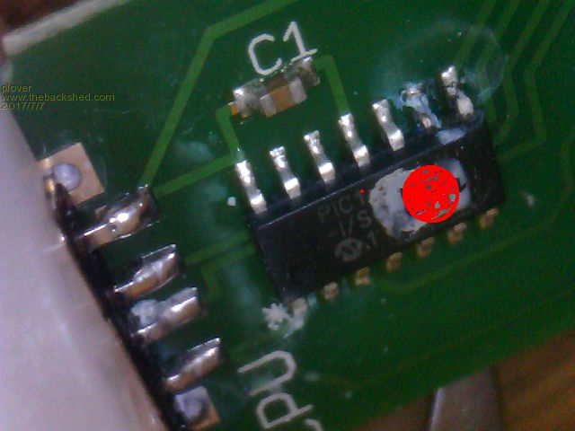

Slip of concentration cost me a small micro in a gas analyser instrument. Because of poor contacts in USB connector I decided to hard wire a usb cable in place. From old times I always remember that many 14 pin ICs have positive on pin 14, well on this chip this is ground and and pin 1 is positive.
I reversed polarity and good bye micro, RIP, and I am sorry.
I have a rework station
https://www.ebay.com.au/i/272041599002?chn=ps&dispItem=1&var=570854548880
858D desoldering rework station
need soic 14 (and 28) pin nozzles
Need a nozzle for this size SOIC
PIC16(L)F1454/5/9
14-Lead Plastic Small Outline (SL) - Narrow, 3.90 mm Body (SOIC)
E1=3.9 mm
E=6.00 mm over legs
D=8.65 mm length
Is there anybody who has found a suitable nozzle to remove this IC?
Any hints where to go looking as so far I have not had any success.
Any other way to remove the chip without upsetting the tracks?

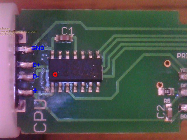

Here is a pic with USB lines annotated.
Should just add that I am reasonably sure I have identified the chip as the 1455 but no guarantee as it is very hard to read after removing a dab of paint hiding details.
