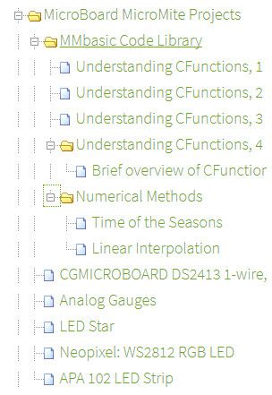

I've offered before and I'll offer again that the CG site can be used for library routines.
The site is behind on updating. I would need help from some "librarians" to capture and annotate various library functions.

This was discussed in a post a while back.
There are two options detailed there. One I believe better than the other (for various reasons )
As Geoff said at the time when I set up the wiki, the problem is keeping the impetus - people forget to publish what they do. Several regular members of TBS have joined the wiki (membership makes it possible to contribute and critique articles - reading is open to all) there is lots of stuff that gets posted here that should be kept for posterity but isn't and forums are not meant to be code libraries.
* Dedicated to doing one task well.
* No single "keeper" - Everyone can add articles at any time.
* Everyone can police/correct/modify articles at any time.
* Rich articles with pix & graphics to support the thinking behind.
* Focused discussion.
* Article history with roll-back.
* Searchable within the wiki.
* Searchable on the web.
At the time I set up the wiki, neither Geoff nor Hugh (the original keepers of the library) had the time or resources to maintain it and having a single person look after it with snippets "sent" in, as it was is frankly archaic - we can all contribute AND share the load - we all should.
This wiki is a free, non-commercial, ad-free, up-to-date as we make it (community driven) method of making sure great stuff stays with the community and stays visible.
