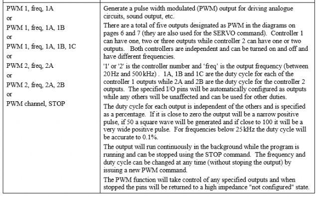

Well here ya go anyways Edited by hitsware 2017-06-29

Yes, I have finally learnt to read the manual BEFORE I post.
