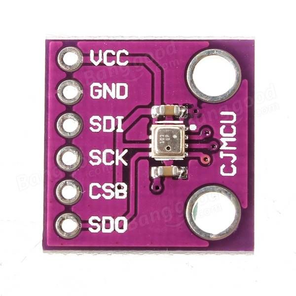

I think I have narrowed my problems down to faulty connections. Embarrassingly in my haste to use the modules I have done a poor soldering job on the pins, probably because I didn't let the iron heat up enough. I have since redone said pins and so far so good. I can remove the USB connector without it interfering with the readings I am getting and the readings seem to be stable. I will leave the Explore 100 running overnight with the BME280 connected and hopefully by morning all will still be well.
Regarding changing the address, I am not sure that I am able to on my module. What pin would I need to ground if I can change it Jim?

Your module looks like it is fixed to the one address.
Mine has small jumper pads that can be used to change the address. I don't think it anything to worry about unless you are trying to do differential pressure measurements.

For the last few days I have been trying to get this particular BME-280 module working reliably with Peter's (matherp) code. Talk about frustration!! I had almost given up and thrown them in the bin when I came across a German website explaining exactly how they should be wired up. It is wired as explained in Peter's code except that SDO must be connected to
  Quote  VCC (0x77) or GND (0x76) for the address.
The SDO pin cannot be left floating; if left floating, the I²C address will be undefined.
Once I had done this the module has been rock solid with no change to Peter's code. Hopefully this will help others who may have been trying to get this module working. There seems to be a lot of different types of BME-280's out there in the wild and this is just one of many.
