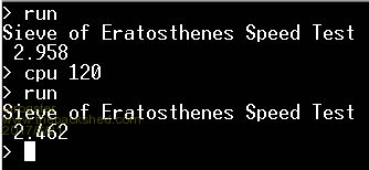

E100 MM+ 470 @ 100MHz = 2.958
E100 MM+ 470 @ 120MHz = 2.462

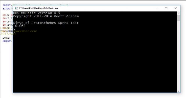

I think I have the record!
Is this cheating?
Phil23
Joined: 27/03/2016
Posts: 1667
Posted: 12:39am 21 Jun 2017
Sorta makes the Pi 3 look pretty impressive Vs the 2.4Gig Core i7 with 16Gigs.
And a bit more than the $60.00 price tag.
Phil.
