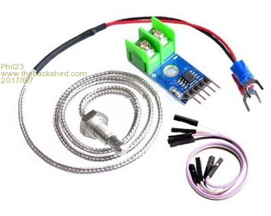

I've got a couple of MAX6755 Thermocouple modules & can see how the data string looks.....

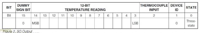

What I'm not clear on is SPI communications & how I get the 2 bytes from the device.
I know CS has to be pulled low??, will something like the example code in the manual be all I need to retrieve the 2 bytes?

Module I'm using.

SPI is not mentioned in the data sheet for the MAX6755, is the board an SPI adapter? does it have separate docs?

Phil23
Joined: 27/03/2016
Posts: 1667
Posted: 01:30pm 07 Jun 2017
I would have read SPI on this data sheet.

Hi Curtis
  Justplayin said   SPI is not mentioned in the data sheet for the MAX6755, is the board an SPI adapter? does it have separate docs?
--Curtis
See:Henrysbench
See:MAX6675 Datasheet It seems to say its got SPI.
I've been using the MAX31855 which seems to work similarly and the SPI works for me.

Reading from the chip is simple.
You can read the whole 16 bits in one lump:
PIN(10) = 1 ' set the pin to inactive
SETPIN 10, DOUT ' pin 10 is the enable signal
SPI OPEN 100000, 3, 16 ' speed is 100KHz, data size is 16 bits
PIN(10) = 0 ' assert the enable line (active low)
d = SPI(0) ' get the whole 16 bits
PIN(10) = 1 ' deselect the chip
SPI CLOSE ' close the SPI channel
The data will be in d (preferably this is an integer).
PRINT "Thermocouple reading =" d>>3
Because this is a type K thermocouple you can get away with treating its output as linear from 0 to 1000 C. So this should be accurate within a few degrees:
PRINT "Temperature =" d>>5 " degrees C"

Zonker, why read 32 bits? As far as I can see the MAX6675 provides 16 bits of data.
EDIT: It might be because Phil's module is using a MAX6675 while you were using a MAX31855 ????
MORE EDIT: On rereading the MAX6675 data sheet, I believe that the SPI open should be:
SPI OPEN 100000, 2, 16 ' speed is 100KHz, data size is 16 bits
ie, sample on the falling clock edge
GeoffEdited by Geoffg 2017-06-09
