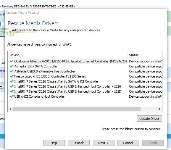

Paul,
one of my PCs is quite similar to your HW, just slightly newer i5
It runs W10Pro
Macrium Rescue is somewhat driver/chipset dependent - these are my drivers:
I generated a rescue ISO and uploaded it to Dropbox
Macrium Rescue ISO Download
I booted a CD generated with the same setups
It takes about 10 Min to come up - but seems to work
Good Luck !

My most recent Macrium image is from 4/8/2017. I have not installed any new software since then and I have made frequent file copies of everything with robocopy so I will get the newer Macrium Reflect Workstation version and see if it works.
I'll post the results after I've tried it.

@BrianP & @twofingers -- thanks for that tip. If I get as far as the command prompt I'll explore Bootrec.
I haven't gotten the monitors moved around yet so that I can try the Macrium restoration. I'll let you know how that goes.
