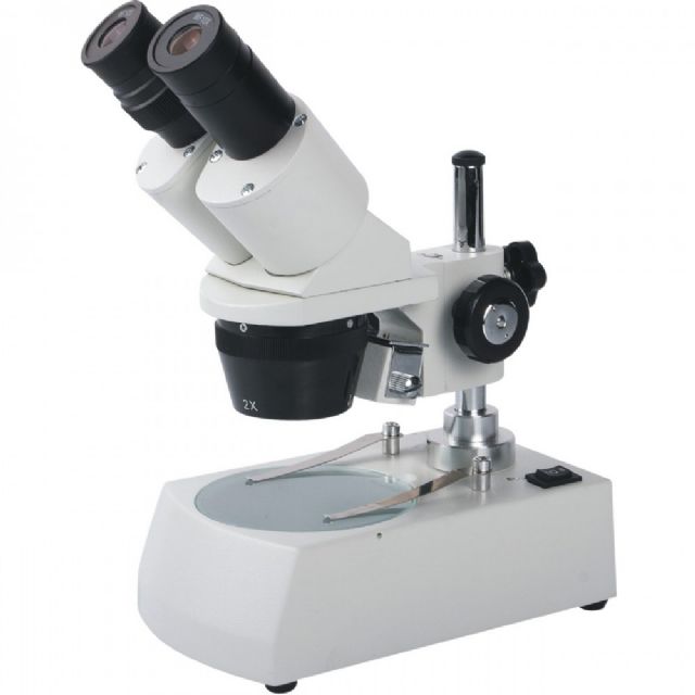

Hi All,
I have been looking at a microscope to do SMD work with and I notice that some have been buying the AMSCOPE brands and rave about them.
I have made inquiry to AMSCOPE about a unit they sell for about $100US and they responded within a day asking for more details (Voltage type and QTY required). I have twice provided them with the information but after nearly 2 weeks they have not responded with a quote so today I gave up and had a search of what was available locally and came up with This Beastie
Which I sourced from MEDSHOP in Melbourne for $107AU inc GST (About $80US) and I could pick one up..
I went and looked at it thinking it might be a crappy Chinese knockoff and was more than pleasantly surprised..
It has the following included:
10x eyepieces (maybe these can be swapped for different powers if wanted).
2x and 4x `bottom lenses' which gives magnifications of 20x or 40x.
Halogen Top lighting and a Halogen bottom light.
240V (spec is 220V) powered (Fixed lead with AU plug)
Rubber eyepiece grommets (Not shown in picture)
57mm focus height which I figure would be fine for soldering iron access.
Spare Halogen bulb and a small wrench (not sure what that is for)
Glass bottom plate (for bottom light to penetrate)
Black (one side) and White (the other) bottom plate for Top light contrasts.
Weight is about 2kg (Guestimate) and is made of steel not crappy Plastic.
All in all a pretty decent microscope, even though it is made in China, I haven't used it yet to solder anything but I looked at PCB that had an RT232 SMD chip and I was quite amazed and figured it would suit the task perfectly.
Anyway I thought I would share as at just over $100AU I think it is well worth it and was the cheapest (besides plastic, battery operated units I found on eBay).
I will update when I have actually used it, although I can't foresee any problems with it. I guess it may not be as good as an AMSCOPE but as they obviously do not want to sell me one, I think this one will suit me perfectly. .
It does what it is supposed to do.

You will love the stereo vision.
You will probably find that you only use the low power settings.
My Amscope unit was sold as one for stamp collectors. The high power eye pieces never get used.
Your price looks great!

Your one is absolutely identical to the one that I purchased from Amscope and I paid about $80 plus $65 in freight. You have an excellent bargain and a well made scope.
Get yourself a couple of x5 eyepieces. That will give you x10 for soldering which IMHO is near perfect.

Hi Mick,
I have an Amscope and by the look of the one you purchased I would say the Amscope is also made in China. Very, very similar to mine. It is interesting what they are advertised as, mine was a dissecting 'scope for biology.
A good find.

Hi Mick. Well done. Your scope is about the same as I paid in freight! Please let us know how it goes.
