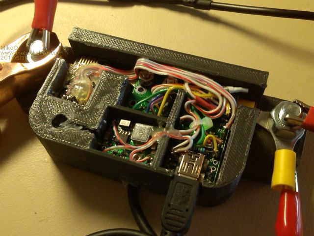

Just a quick post, my latest project using the fantastic little gem from Grogster and Rob. Its a 12v Battery monitor (inspired by BMPRO Device no doupt ) , +-30amps. It outputs on wifi and Usb serial Actual Voltage and current , accumulated Load and Charge AmpHrs , Battery temperature and State of Charge.
Photo shows 3D printed enclosure , Battery terminals, from left ESP8266 wifi, ASC711EX current sense, Explore 28,bottom left Temp sensor and DC to DC PSU.

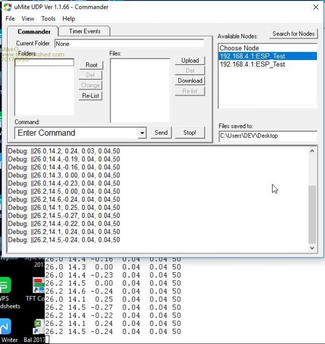

Temp, Volts, Current, Load AmpHrs, Charge AmpHrs, %State of Charge
The photo shows a Windows app displaying data stream via wifi (UDP) and below is the USB serial. The Windows app I wrote some time ago to communicate with ESP8266 UDP protocol, I will probably write a more specific app to communicate with the Battery Monitor for windows, I am also trying to learn(get to grips with) B4A so I can make one for Android phone which would possibly be more convenient. Alternately another uMite backpack with LCD display could be used displaying the serial data.

Really nice job Mike - amazing how neatly a 3D printer can tidy up a heap of modules! What are the dimensions of the 'box'?

Thank's Greg
Dimensions are 120 x 50 x 30mm

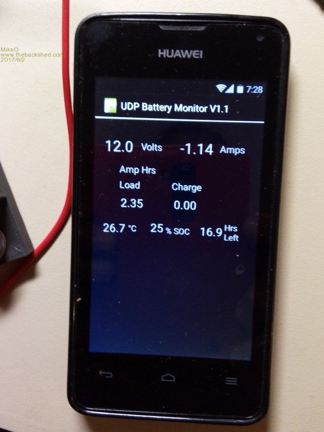

Update, I have written a very simple android app now running on my phone to receive the data stream from the Battery Monitor. This has other possibilities as well i think.

That's a nice box Mike. Did you design it yourself? Did you print it yourself?
Can you help with designing and printing boxes for me?

Hi Paul, Yes its my design and print. Sure I can help what did you have in mind. I started myself about a year ago as like with most things I had a specific need. I have to say I am no cad design person but I get by using simple online tools and quite enjoy it when i am able to construct something that has a real purpose.
