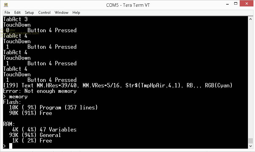

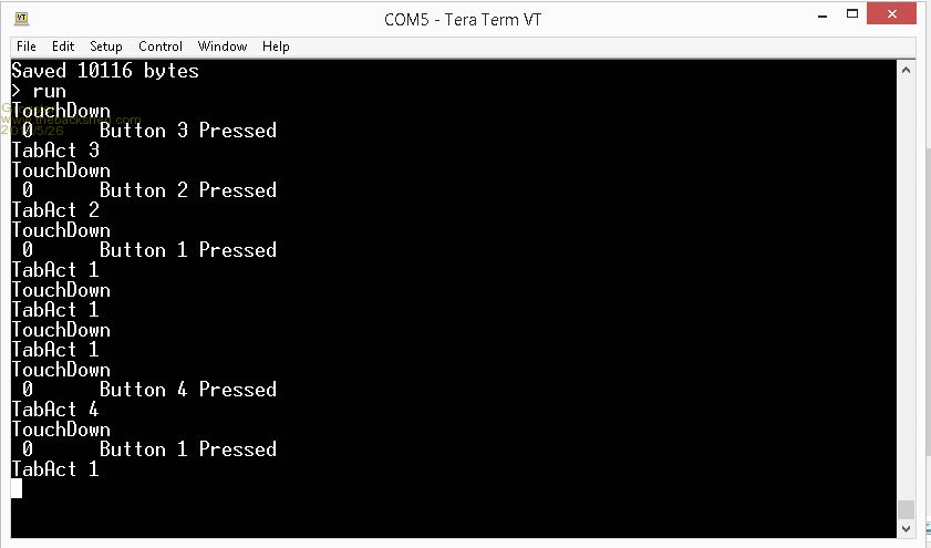

Posted: 11:20pm 25 May 2017
Runs OK for me:
Posted: 11:35pm 25 May 2017
Correction - this DOES throw and error, but you really ARE out of memory:
I can cause this to happen, after touching the FULL DETAIL tab about four times one after another. Something is adding to the size of your variables whenever you call the FULL DETAIL screen.
EDIT: It happens also if you run the program and do nothing - something is gobbling up the memory. If I load one of my other programs into the same E100, it runs just fine, so I THINK this is a coding error. I will have a quick look over your code.Edited by Grogster 2017-05-27
