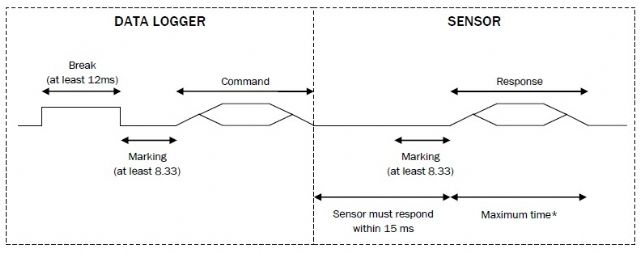

Found a bit more information that describes the timing required. It seems the device requires a BREAK of at least 12mS then a MARK at least 8.33mS before the command.
Tried to upload the diagram but it went to black, sorry. Not sure how to achieve this and still maintain the serial port.

one kludge would be to add a 1k resistor in series with the serial port TxD line. then connect a spare pin of the micromite to the end of the resistor that is away from the micromite.
- when this pin is set as input (default) serial transmission can occur as normal,
- when set to '0' and output, the TxD line will be forced low,
- when set to '1' and output, the TxD line will be forced high,
- when set back to input, serial transmission can resume.
the 1k resistor allows the pin to 'override' the TxD output. the 3mA required to force a different state to the one TxD is in is well within the drive ability of the micromites I/O pins.

I managed to find another copy of the timing diagram:
