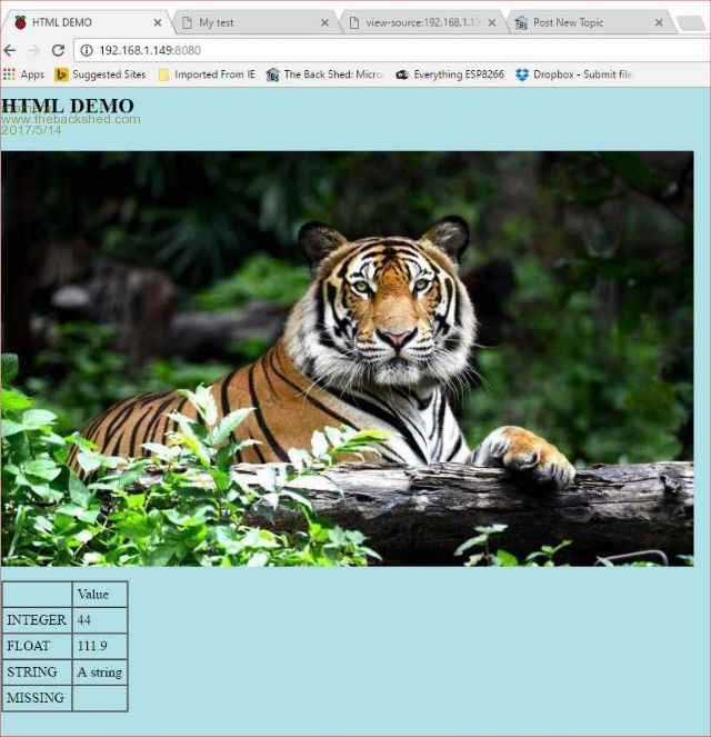

This now includes the full capability to program fairly sophisticated webserver applications with stylesheets, embedded pictures, and favicons entirely in MMBasic
HTML pages can be written and stored as files. These can have MMBasic variable names included within the file in {} brackets and then these will be filled in from the current values in the MMBasic program when the page is requested.
To explain this an example is probably best. Here is the simple HTML file used to create the image above.
<body>
<h2 align='left'>
HTML DEMO</h2>
<link href="styles.css" rel="stylesheet" type="text/css">
<br>
<img src="tiger-3.jpg" alt="mypic">
<p>
<TABLE BORDER='1' CELLSPACING='0' CELLPADDING='5'>
<TR>
<TD></TD>
<TD>Value</TD>
</TR>
<TR>
<TD>INTEGER</TD><TD>{tcurrent}</TD>
</TR>
<TR>
<TD>FLOAT (array)</TD><TD>{tmax(2)}</TD>
</TR>
<TR>
<TD>STRING</TD><TD>{tmin}</TD>
</TR>
<TR>
<TD>MISSING</TD><TD>{fred}</TD>
</TR>
</TABLE>
</p>
</body>
</html>
In it there are four MMBasic variables referenced: tcurrent, tmax(2), tmin, and fred
In my test program (full version below) these are defined as follows:
Option explicit
Option default none
Dim integer tcurrent=44
Dim float tmax(3)=(19.6, 22.4, 111.9,88.6)
Dim string tmin="A string"
Note that "fred" is not defined and I am using option explicit
to display the page from MMBasic we simply use
TRANSMIT PAGE "filename"
The MMBasic software will automatically create a correct HTTP 1.1 header and fill in the page with the current values of the variables. Missing variables will be ignored. Formatting of numeric variables is exactly the same as would be done by a PRINT statement. As usual STR$ can be used for more specific formatting.

You should be able to look at the demo on a Pi Zero W at this address. Let me know if it worksEdited by matherp 2017-05-15
Posted: 11:16am 14 May 2017
  matherp said  Let me know if it works
That page works for me. When I "view source", this is what I see.
