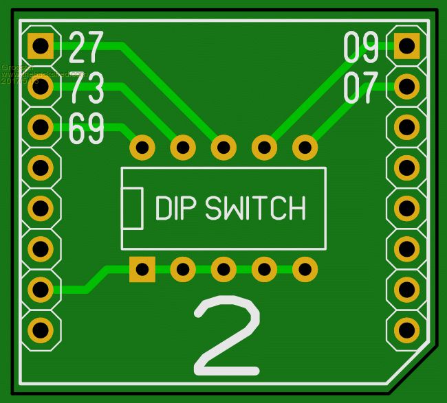

Hi folks.
I just whipped this up, cos I find I often need to have some user-set options, and rather then needing GUI controls or solder-blob pads, this little board would probably be handy. It is designed to plug directly into CLICK socket #2 on the E100, leaving Click #1 for normal use.
In your code, you use the PULLDOWN option, so that any switch that is set, can be determined with the nice IF PIN(POLE1) THEN type syntax(leaving out the '=1' bit on the end of the IF command). Note that I am using the internal pulldowns, and the DIL switch pulls the pin high for that reason. You can't use the syntax above if the pin is already one, and you pull it down with the switch.
The numbers on the silkscreen represent the pin numbers on the E100, so you can easily setup constants for those pins for checking, such as:
CONST POLE1=69
SetPin POLE1,DIN,PULLDOWN
IF PIN(POLE1) THEN.....
The PCB itself will be free - you only need to pay postage, which is US$2 to Australia, or US$2.50 to anywhere else on the planet. As many boards as can fit in an envelope for that same postage cost.
Anyone interested, please let me know by posting on this thread, cos then I will know if I should panellize this board and get more then the handful I was planning on.Edited by Grogster 2017-05-14
