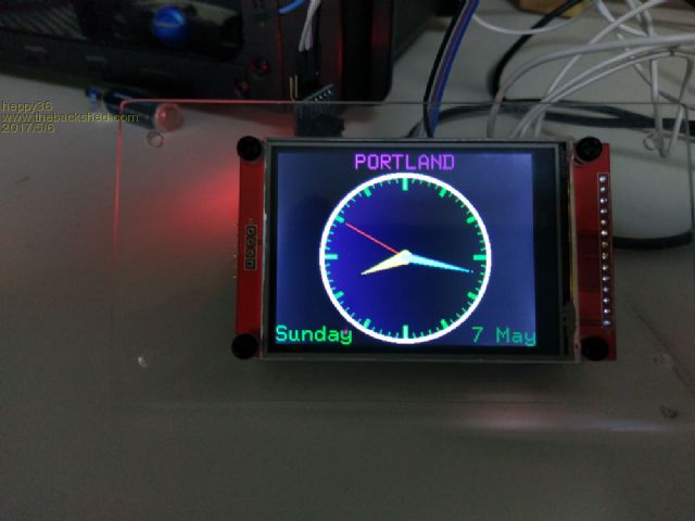

heppy36
Joined: 29/07/2011
Posts: 54
Posted: 12:33pm 06 May 2017
Thanks ,turns out the file I was send was corupt,I re download all good
Heppy
