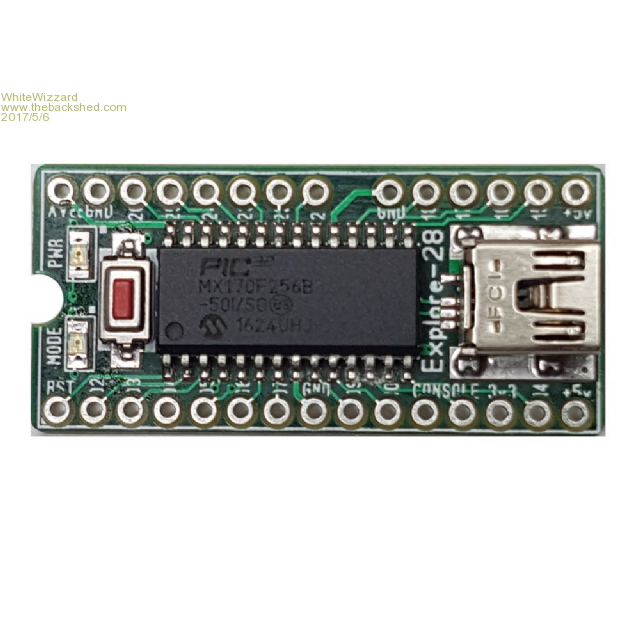

Yes, there is a new version that uses the SOIC 170 chip instead of the QFN, making assembly much easier. Exactly the same size as the QFN version. Tidyed up component placement on the bottom layer. Still has the 1455 USB chip on the bottom layer, also still SOIC.
Me or Rob will start a new thread soon - we are still building the prototypes.
Edited by Grogster 2017-05-06

The QFN was actually not really that difficult to hand-solder, but it took much longer to align and check the pins then the SOIC due to it's very small size. The original revised concept was to use the SSOP chip, then Rob(or WW - he's also been helping behind the scenes) suggested SOIC. I was extremely doubtful that you could ever fit the larger SOIC 170 in there keeping the PCB the same size, but in the actual event, it proved to not be that much of a problem, so WW or Rob - whichever one of those chaps that suggested using the SOIC - were right all along. I think the 1C is a very efficient PCB layout now. 1B was the SSOP version, but was aborted.
All the 1A's produced thus far have been fine(except for perhaps the thread-starter's one?), it was just a design change to make for easier assembly, and a neater layout of the passives on the bottom layer.
Posted: 02:36pm 05 May 2017
I have built a couple of the new E28s, and they are currently under stress testing here.
Confirming that, as expected, this module is so much easier to assemble than the QFN version.
They layout was 'fine tuned' over many emails and I think that Grogs has done a great job on the PCB to fit Rob's circuit within the size it is.
Will be adding the SOIC Explore28 onto micromite.org very soon (for people this side of the planet wanting to get their hands on one)
