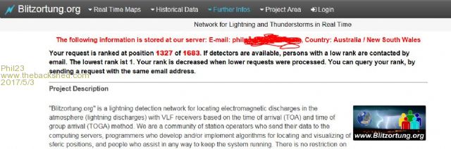

Hi Grog & Lew,
There's another Lightning monitoring product that's very interesting.
The Blitzortung Project. Really good data, but you can't just "get one".
http://en.blitzortung.org
You have to jump in the hardware queue & wait & see what happens.
Could be a good thing to have installed in it RicTech office though.
Help improve accuracy for the region.
