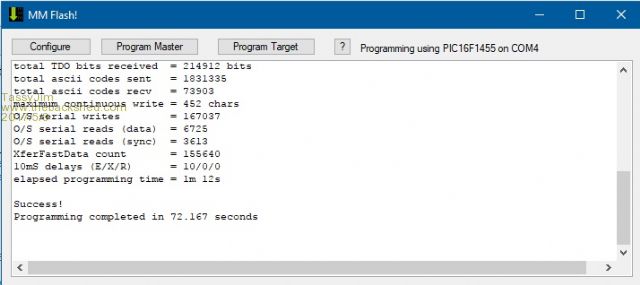

A year or so ago, I wrote a Windows GUI wrapper for pic32prog to make it easier to program micromites using an Arduino or micromite.
Now that we have the Microbridge, I have updated my program to add the Microbridge to the list of supported devices.
I have often used the Arduino method and found it quicker than using the PICkit3.
Now I have a MMX board with the Microbridge built in, I find programming the MMX a breeze.
MMFlash doesn't let you do anything more than you can using pic32prog.exe directly, but I like to think it's a bit easier.
All the hard work has been done by Robert Rozee and Peter Mather. I did the easy bit.

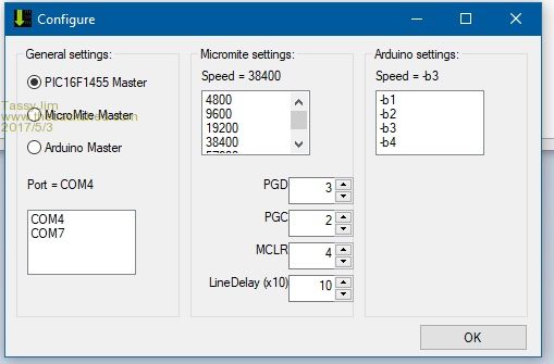

The only thing to configure for the Microbridge is the COM port
Programming the MMX takes about 72 seconds.

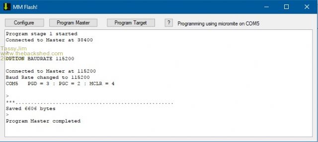

Hi TassyJim
I just tried the new version not sure it worked the old version showed progress bar when programming the master the new doesnt.
Do I have finger trouble
Cliff
Posted: 05:41pm 03 May 2017
  centrex said   Hi TassyJim
I made some changes to the way my program updates the text box.(Trying to stop some silly Windows stuff)
I didn't test programming the either the Arduino (which should be OK) or the micromite.
It is likely that I need to do more work there.

Posted: 07:28pm 03 May 2017
Try downloading from my website again.
It should look better now.
I think the programming did happen, just no progress reported so any problems would have been hard to see.
I am not set up to do any actual programming with a micromite so confirmation that that part works would be nice.

Posted: 08:07pm 03 May 2017
That fixed it can now see the little dots scampering across the screen.
