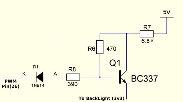

GDay Graeme,
There was an extensive discussion on this 12-18 months ago.
It really is not easy to drive a 3v3 powered LED circuit fully using a 3v3 high level drive)
The circuit below is what I use for my BackPack 170 and does work very well.. The resistor values are pretty tight so you may not get a good result by changing them but it has always worked well using the values shown. I tried a BC558 transistor but could not get full brightness).

Posted: 09:36pm 01 May 2017
Graeme,
The secret to the above circuit is the blocking diode, this allows the transistor bias resistors to pull the base of the BC337 to around 3v8 or slightly higher to turn the transistor on without causing damage to the 3v3 level PIC pin.. The backlight will draw about 60-70mA at around 3v3 when on.
In any case it just works.. All my backlight boards now use this circuit..

Posted: 05:19pm 02 May 2017
most likely the base resistor for the PNP transistor was too high; if your backlighting draws 100mA from the 5v rail, and your PNP transistor has a gain of 100, then you'd need a base current of 1mA. this translates to a base resistor of only a few k's (3k3 would be a safe bet, bearing in mind your losing 0.6v in Vbe of the PNP and possibly a little bit due to Vce of the NPN). and you'd want the base to emitter resistor on the PNP transistor to be quite high, perhaps 10k or more.
the base resistor for the NPN could be fairly high, 22k would be a safe choice.
folks often don't realize that when switching even a moderate load, you can need a fair base current to fully saturate a transistor. you also need to be sure that you are overcoming any base capacitance (in both the NPN and PNP transistors) if using PWM.
