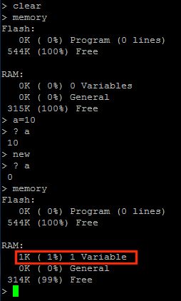

This is MMBasic 5.3 on both MZ and MX processor.
The NEW command seems to clear variables but does not de-allocate the space.
What am I missing?

I believe you re-allocated memory when you printed the variable a to show it had been cleared. Try using MEMORY immediately after doing a NEW instead.
Unfortunately I don't have a 'mite handy to test with at the moment.

  Justplayin said   I believe you re-allocated memory when you printed the variable a to show it had been cleared.
This is correct! It has thrown me a few times too
To see this affect - type a few more PRINT x statements (replacing x with different 'made up' variable names) and then type MEMORY again. You will see the variable count increase for each unique variable you just typed PRINT x for.
