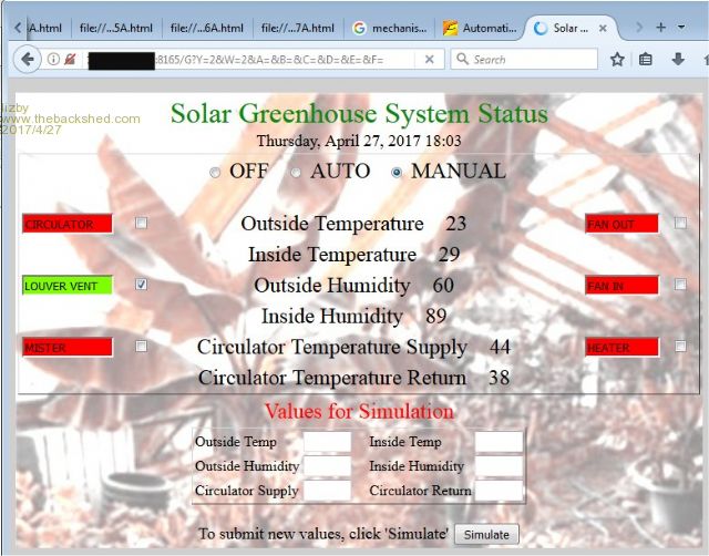

Here is the page I'm serving:
It displays well, but the connection doesn't close, which causes problems with Chrome on a PC (I have to press "Reload") but not on Firefox and other browsers I've tested. The problem also occurs on Opera and Chrome on Android.

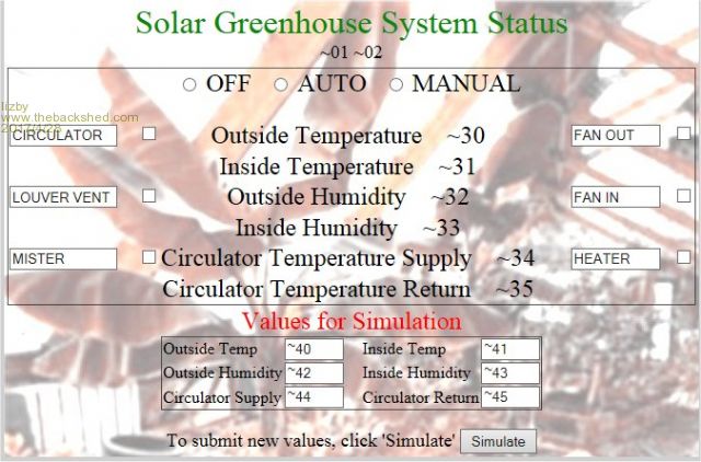

I hand-code an html template and designate variables that I want to be able to change with a "~" followed by 2 digits. For example, I customarily use "~01" for date and "~02" for time. I store the template on the microprocessor--either in eeprom for a picaxe, on the SD for a Micromite Explore-64, or after being coded programmatically as basic assignment statements for the Explore-28--and then run through it in code replacing the "~nn" text with current variable values.
In order to align things the way I want, I use a table as master container, then other tables within it to create a column structure.
The template will display in a browser, though not all the "~nn"s will (because of their use as "checked" fields for checkboxes and radio boxes, or as background color--happily browsers generally ignore what they don't understand).
Here is the displayed template for this application--you can see "~30"-"~35" which will be replaced with sensor readings, and also "~40"-"~45", which can be used to simulate those sensor readings for testing the code when the "AUTO" operating mode is selected.

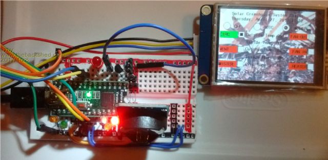

The system also includes a Nextion OLED for local control. The hardware looks like this.
