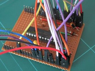

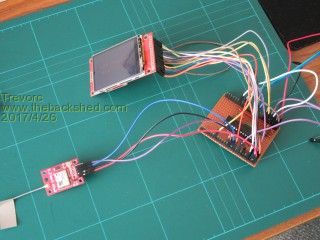

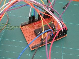

I have attached some photos, though I don't think it will help you much.
Not sure what you mean about U-Blox changing settings as it only a serial(TTL) device.
Hope you can spot something I havn't.
Kind regards,
Trevor
Sorry, I will have to do the photos later. They are too big to send.
Trevorc
Joined: 26/02/2017
Posts: 22
Posted: 01:33am 26 Apr 2017
Hi again GoodToGo,
Hopefully, the photos are attached.
Sorry, I have not posted pictures on this forum before.
Trevor

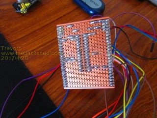

Posted: 02:40am 26 Apr 2017
Hi Trevor,
Do you a photo of the bottom of the veroboard?
Cheers,
GTG!
Trevorc
Joined: 26/02/2017
Posts: 22
Posted: 03:34am 26 Apr 2017
Hi GTG,
I didn't but I have now.
Here it is.
Trevor

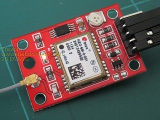

Posted: 05:08pm 26 Apr 2017
Hi Trevor,
I see your gps module is slightly different to mine and has 4.7k series resistors inline with the Tx and Rx lines. I'm betting that's the issue. Try shorting them.
The module I'm using is this one ebay link
You can see there are no resistors....
Let us know how you go.
Cheers,
GTG!

Hello GTG,
Well spotted.
I have shorted the resistors as suggested and guess what, IT WORKS. HOORAY.
A big thank you to WhiteWizzard, Jim and yourself of course.
I may not have found that in a month of Sundays. But I did feel that there was some
problem with the levels.
Thanks again.
