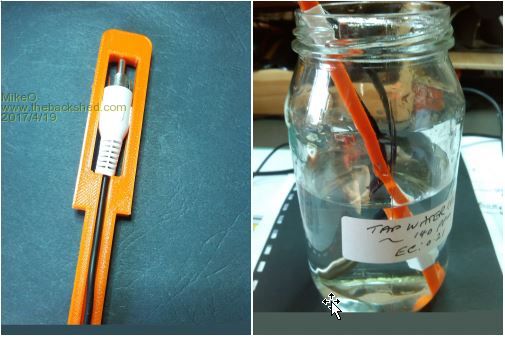

The following conductivity meter is based on an original project for Arduino here
The original used an American 2 pin power plug as a conductivity sensor, my version is a little different using the ubiquitous "RCA" phono plug, seen here complete with 3D printed holder. Link to STL file
You also need a waterproof Temperature sensor (18b20). The Cell is powered through a resistor (470 ohms) from two outputs on the mite via pins ECpower and ECground. Power is applied to the resistor + cell network briefly whilst the junction voltage is measured then turned off, the voltage is then reversed for a brief period to help with water polarisation. The code is fairly well commented and should be self explanatory. Operation is simple and should work straight off but calibration is recommended. I didn't have any commercial standards but was able to make some simple NaCl solutions which seemed to work reasonably well with the aid of this calculator. I made two TDS standards, a 1.5 (1000ppm) and a 3.0 (2000ppm) with 0.29 and 0.58 grams in 250ml of filtered water respectively.
Run the software and follow the prompts, if you are going to calibrate the new cell constant may be saved by pressing the S key, you may need to wait out the 10 seconds cycle time before its is saved. The following is a typical Calibrate and Measurement run.
New Callibration has been saved
Restart in Measure
EC/TDS Monitor (Console Mode) Ver 0.6b
Defaults - Calibration @: 1.5EC - Temp Coefficient: 0.019 - TDS/ppm Conversion factor: 0.7
Cell Constant: 3.52427 Resistance R1/Ra: 470 / 36ohms - Cell Voltage: 3.28 Vdc
Temperature is in Degrees Celcius
Waiting for Keypress (C or M)
Measure
Volt drop:1.031 Temps: 23.25 / 23.25 Resistance: 195.847 Ohms EC:1.50 S Concentration: 1049 ppm/TDS '1.5EC standard
Volt drop:1.030 Temps: 23.25 / 23.25 Resistance: 195.671 Ohms EC:1.50 S Concentration: 1050 ppm/TDS 'as used for
Volt drop:1.031 Temps: 23.25 / 23.25 Resistance: 195.847 Ohms EC:1.50 S Concentration: 1049 ppm/TDS 'calibration
Volt drop:2.012 Temps: 23 / 23.25 Resistance: 766.718 Ohms EC:0.38 S Concentration: 269 ppm/TDS 'Filtered
Volt drop:2.034 Temps: 23 / 23.25 Resistance: 789.868 Ohms EC:0.37 S Concentration: 261 ppm/TDS 'tap water
Volt drop:2.060 Temps: 23 / 23.25 Resistance: 818.633 Ohms EC:0.36 S Concentration: 252 ppm/TDS
Volt drop:0.741 Temps: 23.25 / 23.25 Resistance: 111.777 Ohms EC:2.63 S Concentration: 1838 ppm/TDS '3.00EC standard
Volt drop:0.738 Temps: 23.25 / 23.25 Resistance: 110.809 Ohms EC:2.65 S Concentration: 1854 ppm/TDS
Volt drop:0.737 Temps: 23.25 / 23.25 Resistance: 110.533 Ohms EC:2.66 S Concentration: 1859 ppm/TDS
Volt drop:0.734 Temps: 23.25 / 23.25 Resistance: 109.982 Ohms EC:2.67 S Concentration: 1868 ppm/TDS

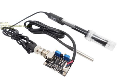

Continuous pH monitoring is what I'd find really useful, but not sure if the readily available probes are suitable for 24/7 immersion for continuous monitoring.
I gather periodical re-calibration might be required, and have seen quite a few continuous pH monitors in service, but they usually have $$$$ price tags.
Anyone here know a good starting point for this type of pH monitoring.

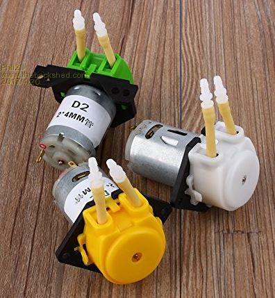

The couple of devices I've seen so far are these, & I could put both of them to use...
It seems to be getting more common for domestic pools to have automatic acid dosing, so there my be a fair degree of reliability available now, given how lax owners can be with correct maintenance.
If you could reliably read pH, it would be easy to calculate acid dose required for a pool to maintain the balance.
I'd assume it would be introduced slowly, main pump running, and the control would be required not to exceed specified 24 hour doses.

  Quote  The couple of devices I've seen so far are these, & I could put both of them to use...
Yes I've looked at those too but don't trust the 'reliability' prospect. The meter (i.e. board) should be pretty reliable - it's amazing how far the chip amplifiers have come, and the temp. probe won't be a problem (you have to have temperature to adjust the pH), the electrode is the issue. Those ones are plastic on the outside and that makes them more robust but the membrane inside will still be very thin glass.
Those pumps are peristaltic pumps - rotating rollers squeezing a tube. They're commonly used for dosing small quantities intermittently; they're cheap-ish and pretty reliable.
  Quote  I'd assume it would be introduced slowly, main pump running, and the control would be required not to exceed specified 24 hour doses.
Yes, definitely with the filter pump running. I think just using a timing basis for dosing would be the way to go. Run it for a few secs, then off for a minute or so to disperse it, then run again etc. several times for a total of 'n' secs to deliver say 100 mls at a time. The acid should be pre-diluted too I'd say (maybe 10:1?). It takes an hour or two for most pools to circulate the water enough to stabilise pH after dosing any chemicals, so you probably wouldn't want to be dosing acid more than a couple of times a day because it will have to be done during the 'main pump on' filtration periods (2x2 hrs/day in winter and 4x2 in summer for me).
