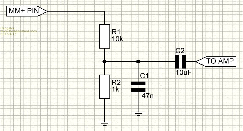

Here is my current output filtering, which is still popping:
R1 & R2 form a potential-divider to drop the I/O pin voltage down to around 300mV to suit the amp I am using, C1 filters off most of the carrier, and the 10uF AC-couples to the amp.
I have also tried the more standard Maximite filter, and the PICAXE filter too. Nothing stops the pops.

What happens if you add a 10k pullup resistor to the processor pin in this circuit?
Posted: 03:01pm 18 Apr 2017
  Grogster said   Yep, tried all sorts of things from caps to pull-up resistors and a cap, but you can't get rid of the loud pop at the start and end of playback.
So, yes, have tried that too hoping that perhaps biasing the pin would help, but it does not.

+1 hitsware...Also maybe the series cap (10uF) would be better straight off the MM output pin...(+ve end to micro) (-ve end feeding the divider)...Also you could bias the output of micro to static mid-point of 1.65V by using say 2 x 100k resistors in series from 3.3 to 0 V...with the junction of the two resistors connected to micro output... this allows you to turn the pin off in MM code, so it would be off at all times when not sending PWM output...this, in combination with the circuit, will allow the MM output to settle and remain at a DC midpoint of 1.65V. (assuming PWM code always modulates [with no DC offset] around a perfect 50:50 duty cycle)
