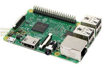

I would think that the lowest effort (and cost) would be made using a Raspberry Pi.

  JohnS said   That was what I thought till it turned out it has to be wired.
Could be a Pi + external LAN board (ENC28J60 etc) but it's about the price of the board I posted and messier.
I must be confused. A Pi has a wired Ethernet port. Hardware could be Pi, LCD, button(s), battery.
