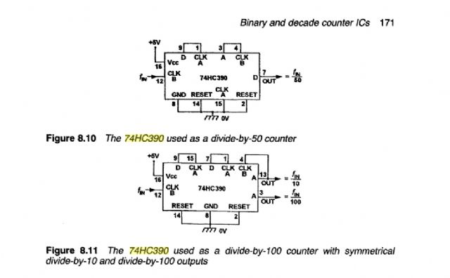

From this Link which is a preview of an ebook available online.
Page 171 has these examples. for /50 /10 and /100

Thanks MIck
I was aware of that reference and it gives me two strappings. But my theoretical knowledge is not enough to extrapolate other strappings from the datasheet!

Posted: 12:49pm 15 Feb 2019
74HC390:
Divide by 2:
in: 1
out: 3
gnd: 2,4,8,12,14,15
Divide by 4:
in: 1
out: 13
12-14
3-15
gnd: 2,4,8,12,14
Divide by 5:
in: 4
out: 7
gnd: 1,2,8,12,14,15
Divide by 10:
in: 1
out: 7
3-4
gnd: 2,8,12,14,15
Divide by 20:
in: 1
out: 13
3-4
7-15
gnd: 2,8,12,14
Divide by 25:
in: 4
out: 9
7-12
gnd: 1,2,8,14,15
Divide by 50:
in: 12
out: 7
1-9
3-4
gnd: 2,8,14,15
Divide by 100:
in:12
out: 3
9-15
1-7
4-13
gnd: 2,4,8
