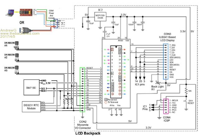

I've finally finished a first draft of my first MM project. Please be gentle (but constructive feedback is very welcome) I have, for want of anything better, called it Ambi-Mon (Ambient Conditions Monitor).
It uses a 28 pin MM on the LCD Backpack, an RTC, a BMP180 and three DS18B20. It has four main displays:

This is the schematic:

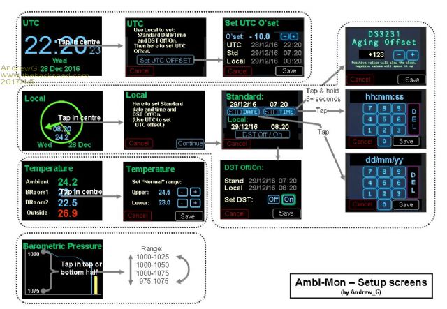

and the set up options look like:
The code is below. I'd appreciate improvements and any comments about how I could have posted the information any more effectively?
