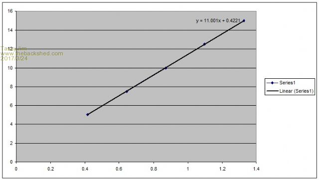

Posted: 06:32pm 23 Mar 2017
I cheat and put the readings into an excel spreadsheet then add a trendline to the graph
A very linear set of data points.
The formula is V = x * 11.001 + 0.4221
In your setup, the voltage drop across the diode is 0.4221V

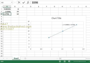

Ok, so I decided to bring the micromites voltage up a bit by doubling up on the 100K resistor (they are SMD) making 10k/50k divider and taking 3 readings:
6.00V 0.863441
10.00V 1.52581
14.00V 2.17742
The Micromite calculated the gradient of 6.08838 and offset of 0.710313 using the 6v and 14v values to get the gradient & 10V value to calculate the offset.
Loading the figures into EXCEL:
The equation is not far out but when I take further measurements using these figures at 6.00v input I get 6.48445 and 12.00v I get 12.4812. I still cant see why there is a variation during normal program execution and the calibration area of the code.
Graeme

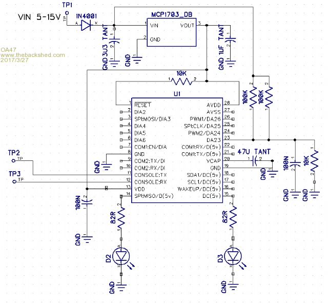

isochronic
Joined: 21/01/2012
Posts: 689
Posted: 06:19pm 26 Mar 2017
4066 ???
circuit ????
"micromite voltage divider" ????

flip
Joined: 18/07/2016
Posts: 137
Posted: 10:38pm 26 Mar 2017
For 6V input should read exactly 1/6 of 6V = 1V. 10/(10+50) = 1/6.
If you're using it to work out voltage at TP1, maybe better putting top of divider to TP1, otherwise, with circuit as-is you could get variation of maybe .3V depending on the variation in current load during sleep.

[I wish I could produce schematics that fast !!]
I think the A/D supply (which is also the ref voltage) is getting hash from the regulator, try a 0.1 uF bypass (ed -ceramic). There is a Silicon Chip project, I forget whether it was a voltage reference or power monitor, that had a similar set up and problem, fixed OK. There are a number of other things but that would be the most citical I think. Also diode voltage drop alters with current to some extent, even for schottkys.Edited by chronic 2017-03-28

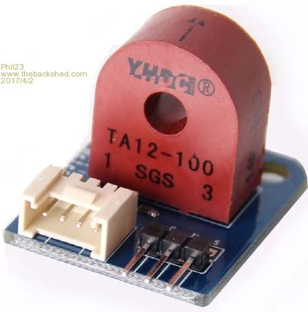

So I had also bought a couple of these...
Haven't yet decided which devices to actually use.
1000:1 ratio & 200ohm shunt.
Says 5v out @ 5A which will be AC, but not sure how to deal with the 0.7? of 1.4? lost in rectification.

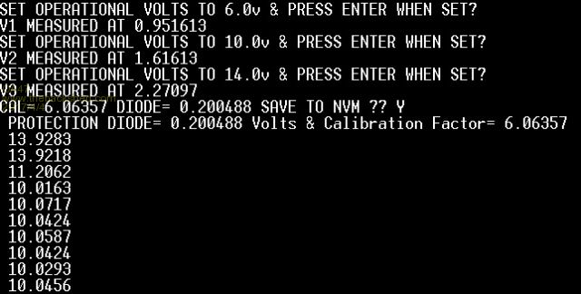

As per my earlier post I received the following samples :
6.00V 0.863441
10.00V 1.52581
14.00V 2.17742

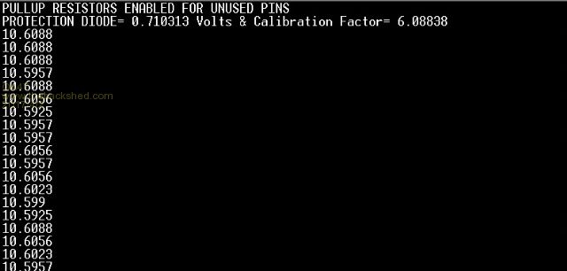

The issue is that the future voltage readouts made every two seconds after for a 10.00 Volt input are consistently approx. 0.6 Volts out. I am at a loss to figure out why.
