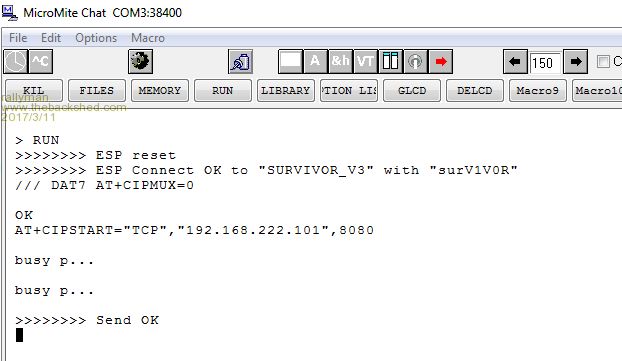

After that I try to open the TCP session to my server and there comes the issue... I also run a whireshark on my server and there is no incoming packets ever. In the debug of MMBASIC, I can see there is a "busy" message after the AT+CIPSTART line...

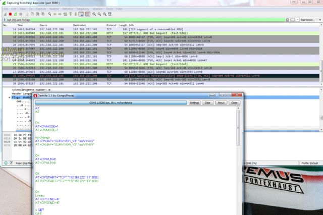

I tried to figure out it is an ESP or PIC issue. If I connect the ESP directly to my pc via serial usb uart converter modul, I can use 'putty' or 'termite' program and I can communicate with AT commands perfetly and I also see the incoming session in my whireshark log.
But, unf. when I connect the ESP back to the PIC, it start, can connect to wifi, it is pingable, but cannot open the TCP session, because of "busy"...
1. pict: direct connection ESP_to_PC, manual send AT commands via termite
2. pict: ESP is connected via the PIC32, commands send by MMBASIC code, no any incoming tcp session from the ESP to the server.

ajkw
Joined: 29/06/2011
Posts: 290
Posted: 06:11pm 17 Mar 2017
BECAUSE,
At the end of each Print command MMBasic sends it own CR LF
so
PRINT #5, "AT" + chr$(13) + chr$(10)
sends AT CR LF CR LF
and that triggers the Module to reply with busy p...
so
use a semi colon (and MMBasic will suppress its own CR LF)
PRINT #5, "AT" + chr$(13) + chr$(10);
or of course just
PRINT #5, "AT"
to send AT CR LF and get a happy response from the module.
