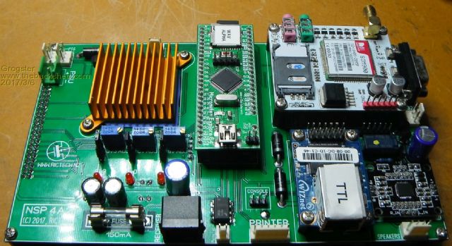

  Grogster said

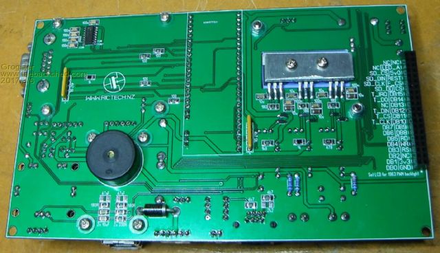

There is a fan that goes on the top of the heatsink, but this is not shown.
The two 3mm bolts secure the three regulator IC's to the bottom of the heatsink, using a bit of 3mm aluminium plate as a load-spreader/clamp thing.....
  Grogster said   It is a replacement security system. This is the new replacement for the old system that was cooked in the October lightning strike from God, which used the old - now obsolete - uALFAT filesystem module that I had a bit of a mission finding temporary replacements for. That system was PICAXE based(28X2) with the filesystem module and a TellyMate chip for B/W video output on a standard TV screen.
This one uses the MM+ and a colour touch-screen. Much sexier then the PICAXE system.
The old system used a very noisy, big and heavy dot-matrix printer for printing messages. The new one uses a relatively silent thermal printer which is panel-mounted with the LCD to keep things nice and tidy.

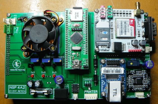

Here is another photo complete with fan this time.
A YouTube video is a nice idea - I will see what I can do.
