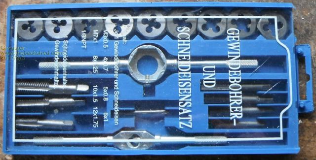

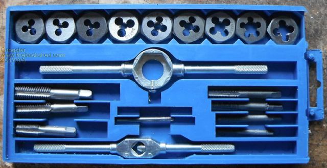

This is the crappy set I have:

I never broke the drill bit, it was just the tap, and that was only cos it got so tight - but I get the feeling from this thread thus far, that I was actually doing it wrong. Should have been backing it off, then going back in. I wasn't doing that, so....snap!
