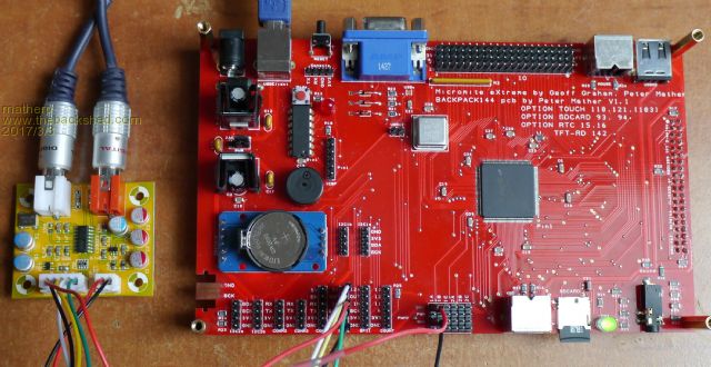

I2S Dacs are cheap and readily available. In the picture I'm using this one

Connections to the DAC are as follows:
MCLK - SPI3-IN (this is re-configured as an output of the clock signal and runs at 128 to 512 times the frame clock depending on the frequency allowing the DAC to oversample.
DATA - SPI3-OUT
SCK (Bit-Clock) - SPI3-CLK
LRCK (Frame-Clock) - pin-97 on the 144-pin, pin 68 on the 100-pin
All these pins are available on the SPI3 header on the Backpack144
Connections for the 64-pin chip are as follows:
MCLK - Pin-13
DATA - Pin-45
LRCK - Pin-30
SCK - Pin-29
For DACs with an inbuilt MCLK this connection can be omitted.

Couple of notes on the DAC I'm using pictured above.
On mine the red and black wires on the power connector were reversed, the silk-screening is correct.
The DAC has a 50MHz oscillator for MCLK connected via a 100R resistor next to the oscillator. I removed the resistor to use my MMX generated clock. I haven't tested with the on-board oscillator. It seems more sensible to have all three clocks fully synchronous.
The sound quality though my good amp/speakers is outstanding - certainly better than playing from the source CD with my CD player. All of the clock generation in the MMX is done in hardware directly from the 24MHz oscillator and looks totally jitter free on the scope. I personally can't hear a difference between 96KHz and 192KHz but that may be because of the sample FLAC files I've found on the web and downloaded.Edited by matherp 2017-03-05
