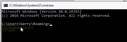

Hi Paul,
Based on you post I tried this bit
(Alternatively you can open a file explorer window and navigate to the installer location. Once there you can type 'cmd' in the address to open a command prompt.)
Well I wish I had known about this 20 years ago as it does open you up a command prompt in the right directory(on windows 10 but it probably always been there)
1. Navigate to the required location on explorer.
2. Highlight the path by click ad left edge of it
3. Type cmd to replace the path
4. Hit Enter and you have a command prompt in the required directory
Gerry
