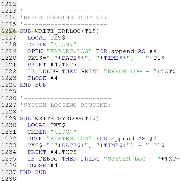

I have two subs that I call as and when needed, to log system errors and other system activity. They usually work fine, but tonight they have started doing odd things.
The two routines are:
...and the error I am getting from this code is:

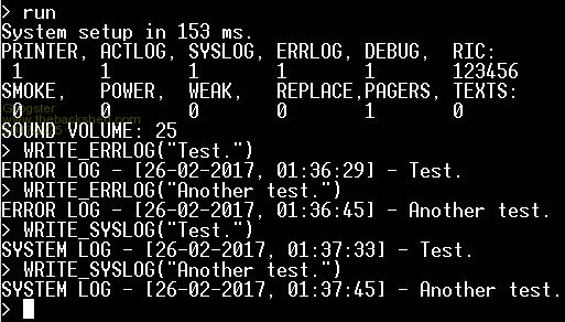

...yet, if I run these directly from the command prompt, there is no problem:
It's damn peculiar. I have searched for all instances of "#4" in the code using MMEDIT's search feature, and have confirmed that each and every time that handle #4 is opened, it is always closed again. It is never left open.
Note also that as part of the SUB being called, I close that handle before leaving the routine. The next time I call that routine, I get this error message about the handle already being open.
BUT, I can call either sub from the command line as many times as I like - no error message, but when the code is running, I do. This suggests that I have accidentally left handle #4 open somewhere else, but according to my MMEDIT search for "#4", anywhere I open it, it also gets closed.

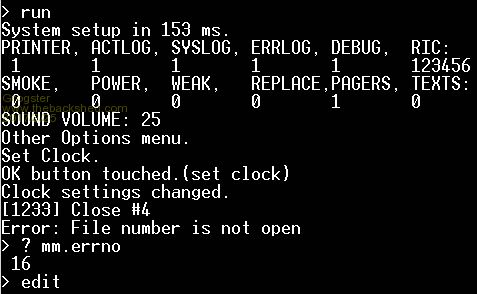

EDIT: One last thing before bed, I tried simply putting in a "Close #4" just before the open command, but then I get a different error: "File number is not open.", along with mm.errno being 16. If I remove that CLOSE #4 and run the code again, I get the other error about the file already being open - WTF?! It can't be both....
