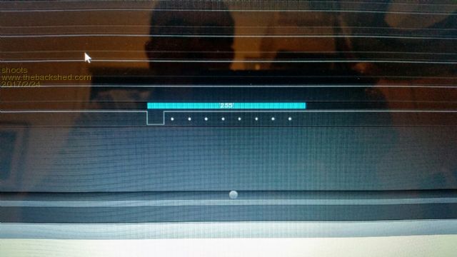

I fed the output through a CP2101 to real term and get a FF every cycle.

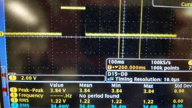

The output of pin 21 registers a pulse on the cro
from cro:
From the data analyser:
Any suggestions please?

I would choose a higher baudrate and then use the "zoom" knob on the Tec scope to expand the scope's capture buffer to get a better view...

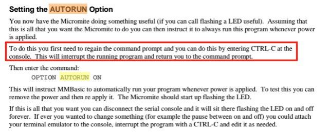

I left the Autorun option on as this instructs it to start as soon as the power is on:page 11 of manual. Without ON it will not start when power is reconnected. It might be OK if instructed ON from the terminal but I want it to be independent.

You may have missed zonker's point about autorun.
It is not a command you issue "in your program" it should be set at the console before you run or hit F2 or whatever.
Consider a brand new virgin MM, you load this program (do not run it) and drop the power... how will the program know to run when it wakes up again? You will never have issued the autorun command.
you should issue the command only once, at the ">" i.e. when no program is running.

This issue seems a bit odd to me. From what I understand there is nothing negative about including OPTION AUTORUN ON in the source of a program itself, and for any code that I have for a MicroMite that I run on a "finished" bit of hardware the autorun is in the source code.
Where I don't have it is in temporary code that I run just to test something out, as that code doesn't need to run immediately from reset.
It was suggested to include OPTION AUTORUN ON in source code here on tbs, and I've seen it in some example code.
I don't think that there is any harm in having OPTION AUTORUN ON in the code - I don't believe that the option is rewritten to flash if it was already set. (That was a suggestion, but I'm not privy to the source.) If it is needlessly rewritten, then perhaps wearing out FLASH would be a potential problem.
