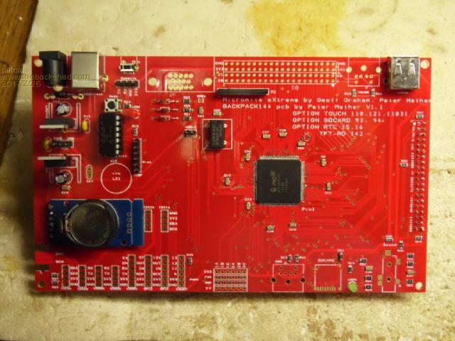

Posted: 11:05pm 25 Feb 2017
It is up and running and the Heartbeat LED is flashing. Here is a picture, still a few sockets to mount (waiting on delivery), the PIC soldering is probably not 'factory' but looks are not everything.
Paul.
Edit. A big thankyou to WW for his help and also Geoff and Peter for all the work they do for no return except the satisfaction of helping others.Edited by palcal 2017-02-27
