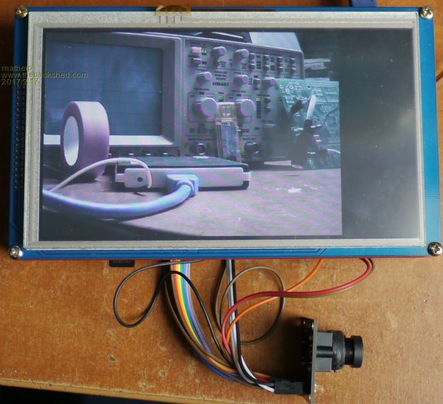

Release 5.3.05 for the Micromite eXtreme now includes support for capture of VGA (640x480) images from an OV7670 Camera.
2017-02-17_132430_MMX5.3.05.zip
This is the cheap version of the camera without the FIFO buffer. The camera command is not available on the 100-pin part.
Connections to the camera are as follows:
3V3 VCC : GND GND
SIOC I2C-CLK : SIOD I2C-SDA
VSYNC Pin-82 : HREF Pin-81
PCLK Pin-83 : XCLK Pin-36
D7 Pin-68 : D6 Pin-67
D5 Pin-66 : D4 Pin-65
D3 Pin-46 : D2 Pin-45
D1 Pin-44 : D0 Pin-43
RESET VCC : PWDN GND
The camera only works when a 800x480 SSD1963 display is configured in 16-bit mode
e.g. OPTION LCDPANEL SSD1963_7_16, RL,, 142
This is because the code uses the display to buffer the incoming image.
If the display is configured with the RD pin specified, as above, then the camera image can be saved to SDcard as a .BMP file
Commands to operate the Camera are very simple:
CAMERA OPEN ' initialises the camera ready for use
CAMERA CAPTURE ' takes a 640x480 picture which is displayed on the TFT screen. This can be done as many times as required while the camera is "open"
CAMERA SAVE "filename" ' saves the on-screen 640x480 image to the SDcard. If the file extension is not specified then ".BMP" is appended
CAMERA REGISTER register, value ' can be used to change the camera settings see the datasheet for details
CAMERA CLOSE ' disables the camera and frees the allocated pins
The images are quite sharp once the focus is adjusted but the colours seem quite muted possibly as the camera only has 8-bit colour capability (+ 8-bit intensity). If anyone knows how to improve the colour rendition let me know.
This release also includes a general facility to save the current display on SSD1963 and ILI9341 displays to the SDcard as a .BMP file.
The command to do this is:
SAVE IMAGE "filename" ' The image is full screen 800x480, 480x272, or 320x240 as appropriate. If the file extension is not specified then ".BMP" is appended
I'll post the updated manual on this thread once done

Posted: 04:52am 18 Feb 2017
  Quote  What is the cycle time for the capture
Watch this to find out
Each frame is completely re-writing the screen.

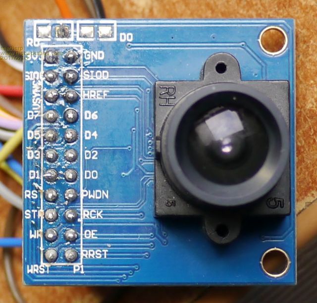

I've updated the firmware to now also support OV7670 modules with a FIFO (video is of this version). The firmware version number is still 5.3.05 as the change relates only to the camera.
2017-02-18_144332_MMX5.3.05.zip
To use these open the camera with the command
CAMERA OPEN FIFO
Wire the camera as follows:
3V3 VCC : GND GND
VSYNC Pin-82 : HREF N/C
STR N/C : RCK Pin-81
WR Pin-84 : OE GND
WRST Pin-82 : RRST Pin-83
There are apparently at least two versions of the OV7670 with FIFO. Mine is a V1 one with the 22-pin connector. This version requires that WRST and VSYNC are connected together as in the list above. V2 versions have this connection made on the PCB, have a 20-pin connector, and omit the WRST pin and the STR pin.
Edited by matherp 2017-02-19

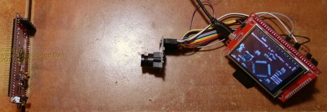

Posted: 09:23am 28 Feb 2017
I though it might be fun to implement some camera support on the 64-pin Micromite eXtreme.
By restricting the image to the size of the ILI9341 display (320x240) it is possible to temporarily buffer a complete picture in the Micromite memory. This can then be written to the, comparatively slow, ILI9341 display and then, if required, be saved to disk.
The syntax is the same as the 144-pin
OPEN CAMERA ' initialises a standard non-fifo OV7670 camera
OPEN CAMERA FIFO ' initialises a OV7670 camera with an AL422B FIFO chip
CAMERA CAPTURE ' takes a picture and displays it on the ILI9341 display
CAMERA SAVE "filename" ' saves the picture to SDcard as . .BMP file
pinout for the non-FIFO camera is:
3V3 VCC : GND GND
VSYNC Pin-12 : HREF Pin-11
PCLK Pin-17 : XCLK Pin-16
D7 Pin-3 : D6 Pin-2
D5 Pin-1 : D4 Pin-64
D3 Pin-63 : D2 Pin-62
D1 Pin-61 : D0 Pin-58
for the FIFO version it is
3V3 VCC : GND GND
VSYNC Pin-12 : HREF N/C
D7 Pin-3 : D6 Pin-2
STR N/C : RCK Pin-17
WR Pin-16 : OE GND
WRST Pin-12 : RRST Pin-11
Firmware version to support this is here
Taking a picture and saving to disk each take just under 1/4 secondEdited by matherp 2017-03-01
