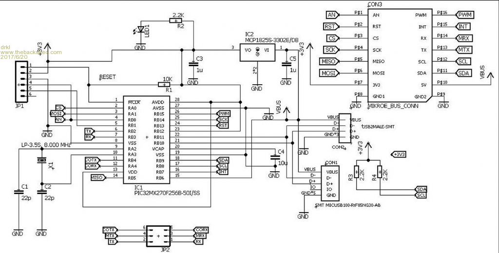

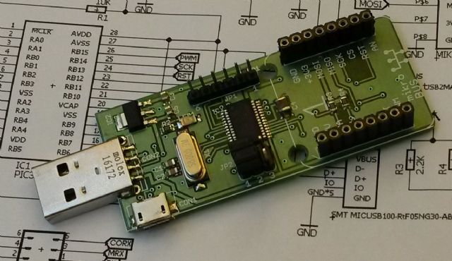

In case anyone is interested in the MX270 version, releasing here the gerbers for probably the simplest development board for it. I have no plans to manufacture and sell any of these but they can be easily assembled by hand at home.
All components are 1206 or similar size for easy manual assembly. PCB size is 77x37.5mm.
2017-02-19_130143_MX2.zip
http://rittle.org

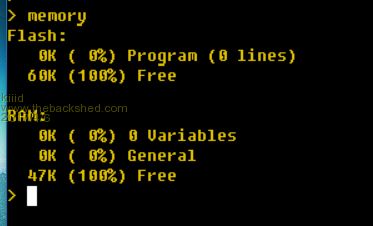

Is the memory available decreased (ie because of the usb stack) ?
kiiid
Joined: 11/05/2013
Posts: 671
Posted: 08:15pm 05 Apr 2017
http://rittle.org
