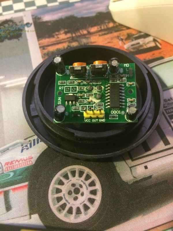

PIC32 has 3,3V and 5V output pin, have connected the pir to the 5V now. (yes, red is the VCC and brown is ground)
I think it should be enough for this setup to get 1 pir work.
I can not change the VCC and ground, because it is clearly written on my pir:

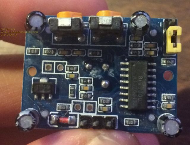

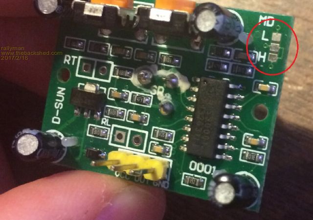

1: Looks like you need to set the jumper option in the top right hand corner (as in your photo) marked with H and L
Reading the data sheet, I would personally short both the lower two pads (i.e. H) to provide a continuos logic high level when movement is detected

1) my sensor is default H
but I also have pirs with jumper:
So I have changed my code to pulldown version.
Now,it never gets any motion detected :(
I have also tried to short out the pir_out leg working like this:
This is stange, because I can never blink the led :(

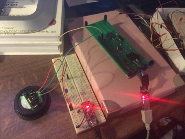

OMG :(
I have create a setup wiht my arduino panel and it works fine :(
there is sg wrong with the GRN and 5V output on the PIC!
Now i have a setup where I get the GRN and 5V from the arduino panel via usb and I get the pir_out and led_pin connected the the PIC pins. Now all the codes and wires are working fine...
