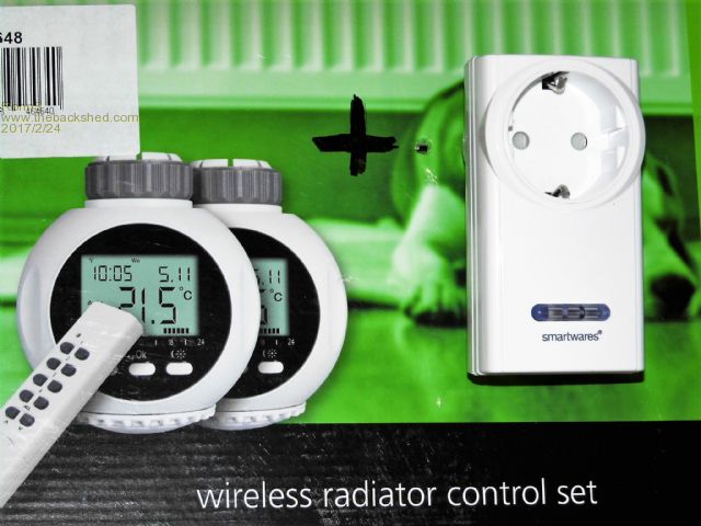

Hurraaa I finally got it to work (first steps)
this is the begin of my or our Micromite controlled "Smart Home-System"
My vision is a Micromite to control all my home radiator valves, switching and diming Lights and others
first ab very big thankyou to Peter Mather for his BitBang-CSub
the details:
i choose the 433,92 Mhz System there are cheap transmitters and actuators available
needed parts:
1) a SMARTWARES Radiator Valve
http://www.homewizard.co.uk/smartwares-wireless-radiator-valve.html
2) a 433,92 Mhz Transmitter
http://www.watterott.com/de/RF-Link-Sender-434MHz
3)a 433,92 Mhz Reciver
http://www.watterott.com/de/RF-Link-2400bps-Empfaenger-434MHz
4) a cheap Generic USB Saleae Logic Analyzer, China clone for about 6 dollars
and as software for windows : "pulseview"
https://sigrok.org/wiki/PulseView
so you can start it
the Smartwares Valves use as Transmitting Protocol a Protocol named "Arctech-switch"

Posted: 12:58am 24 Feb 2017
hello..the news:
now I can control these two units
and i took deeper look at the Arctech protocol so i found thats only one line of code needed to change the Status and the unit-number
i have made a little usable code ( Micromite 170 28 Pin) under use of Peter Mathers bitbang CSub -
That makes everything a bit clearer and I commented the bits to be changed

Posted: 05:19am 08 Mar 2017
very good news,
hello Gerry, i have got it, your Code just running with my "smartwares" Parts i have done some adjustments and changes,particular at the 433Mhz Sub and now it works
for testing i have added a 4x3 keypad , and some new "Smartwares" parts_ a dimmable lampholder an an Wall mounted dimmer for switching and dimming lights
the big wrong point was the loop in the 433Mhz Sub to bitbang the codes out
the repeatloop may only affect the bitbang csub, elsewere the saturation need too much time ( all new calculations) and the polarity is reversed .----- if not so
the code for the Arctec_switch_protocol with 3 Units:
