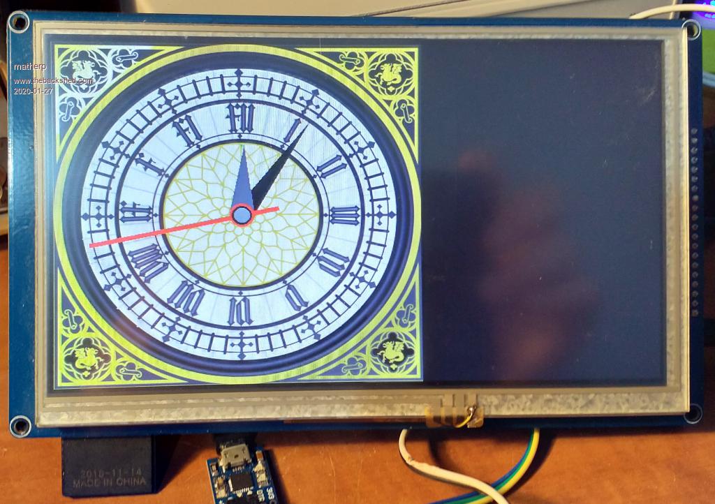

I have recently been trying to get Matherp,s Big Ben clock running on an explore 100 with the 5 inch lcd backpack - I have cut and pasted the associated code -which was attached to the post -"the impossible takes a little longer"- into MM EDIT- and also resized the bitmap image to 480 by 480 pixels on the SD card- when I run the program I first get a nice ,screen filling picture of the bitmap followed - a few seconds later - by a small red circle at the centre of the image - this also remains for a few seconds at which point the display degenerates into random horizontal and vertical lines and colours - the error message "read buffer is 93.12 -or 116.5- or some other random number - used" followed by "pin 30 is invalid"
is anyone able to suggest a possible fix to allow the beautiful Big Ben clock shown in the post -to display - complete with moving hands

I am trying to get the above code to work on a Picomite with ssd1963 TFT.
I know this is an old topic but I wanted to create some large gauges that the pointer didn't wipe the background.
I get a "dimension" error at the line 'i=getscanline()'.
Was 'getscanline' only available on the 100+ where it works flawlessly, or is there an alternative?

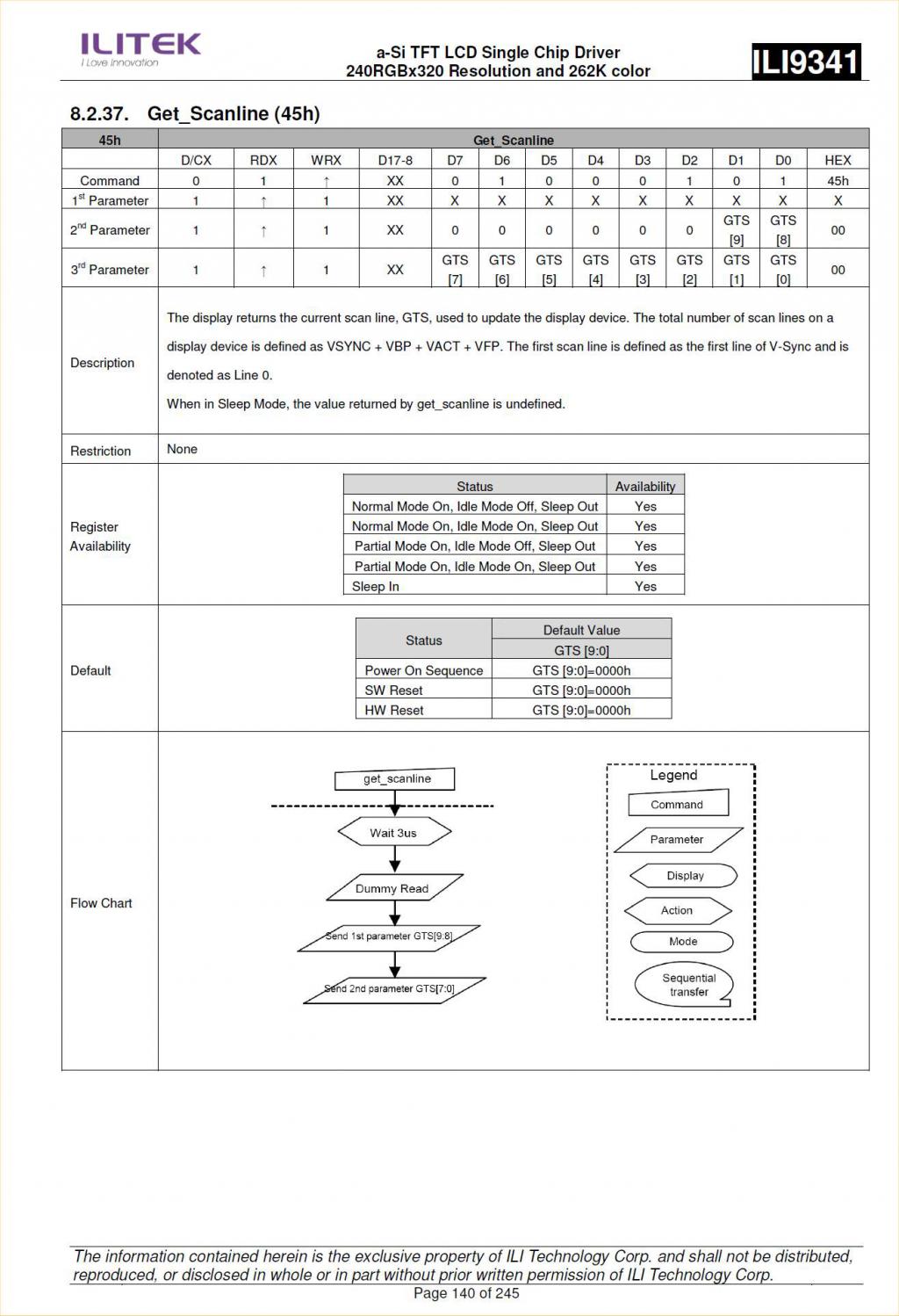

Posted: 08:32am 10 Oct 2022
  Quote  getscanline isn't relivent to a LCD display, so won't be in that version of MMBasic, LCDs are not scanned, at least not in the sense of a monitor or TV screen,
Actually, they are scanned exactly like a television. Most LCD controllers have commands to allow you to read the scanline. However, this can only be done if you can read from the display in the first place. So in PicoMite terms this would be on displays that support BLIT. ILI9341, ILI9488 (possibly), and SSD1963 could be possible but this hasn't been implemented.
Edited 2022-10-10 18:39 by matherp

lew247
Joined: 23/12/2015
Posts: 1709
Posted: 04:17pm 11 Oct 2022
This is Peter's post for an E100 with the clock working
from this thread
  matherp said  The attached definitely works on a E100 running latest firmware.
Load the code, then reset the CPU to execute the MM.STARTUP. Then RUN.
Alternatively save the CSUBS and MM.STARTUP in the library.
