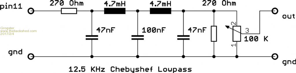

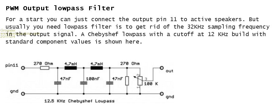

I found these very interesting images and schematic for an RLC low-pass-filter on the web tonight:
All these screenshots are captured from this website.
What I like about this one, is that it's output waveform seems very respectable vs input PWM signal, and as it was designed to work with the 8-bit Arduino PWM output, this should jive perfectly with the 8-bit PWM output from the MM+ and it's new WAV playback feature.
Do any of the members have any thoughts or comments on this?

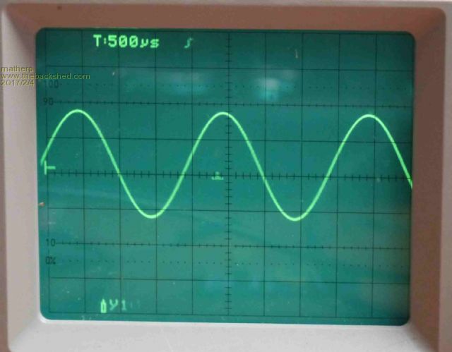

This is the waveform I get with the existing single pole filter - 500Hz sine wave
The MM+ and 200MHZ MZ use a 80KHz PWM rather than the 32KHz used in the Arduino example. The 252MHz MZ uses 96KHz
The filter above is set too low as the WAV output can cater for 16Khz input sample rates on the MM+ and 200MHz MZ. The 252MHz MZ can also use inputs with 48MHz sample rates.
There is no doubt the Chebyshef would do a better job but this is probably a case of diminishing returns

Hi there.
That CRO shot of the actual MM+ output is excellent - that works for me.
Is this with the filter on page 23 of the advanced manual?
2x 2k, 47nF and 1k per channel.
Chebyshef filter idea aborted.
As I did not see that waveform on the output of the MM+ until you posted the photo above, I was not aware it was actually THAT clean, so we'll just ignore this thread now.
Posted: 01:12am 04 Feb 2017
The filter in Geoff's circuit is just 1K into 47nF. The rest is a potential divider. The picture was actually taken from the output of the LM386 on my 100-pin MZ board. The biggest issue with sound is making sure the input and outputs from the amp aren't clipping.
In my case the amp is fed with 5V and has a 20x gain so I need to make sure the input signal is something less than 250mV. I'm using 4K7 and 270R to do this. I'm also AC coupling Geoff's circuit to the input of the amp using a 0.47uF polyester capacitor
