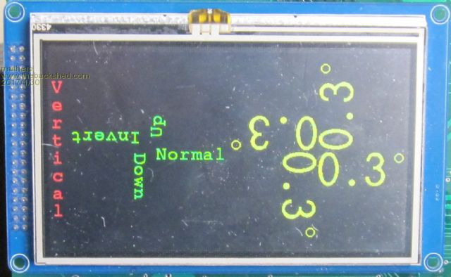

Text output in all orientations
It supports text output in all four orientations + vertical directly from Basic on all supported displays including VGA. This is achieved by simply including the orientation in the justification string so:
text 100,100,”ABC”,ICM
will output ABC inverted with the string centered on 100,100 horizontally and vertically. Valid codes are N(ormal), I(nvert), U(p), D(own) and V(ertical)

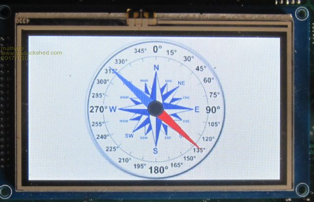

Sensor fusion for applications needing orientation information
It supports automatic calculation of pitch, roll and yaw from 9-axis sensors allowing applications like a tilt-compensated compass to be programmed entirely in Basic - code attached below
watch the video

This sets the 4.3” SSD1963 display up in 480 x 864 (landscape or reverse landscape) or 864x480 (portrait or reverse portrait) pixel mode. The screen viewport is 480x272 or 272x480 and the position of the viewport is controlled by GUI STARTLINE n. This mode of operation allows display updates to be done on a non-visible part of the graphics memory and then the viewport moved to see the updated image completely eliminating tearing effects. The 4P display controller is fully compatible with TOUCH, MOUSE, CURSOR and GUI controls. and is used in the compass program
