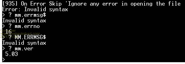

I am seeing this error too, whenever I try to use ON ERROR SKIP. Following the initial error, I also am not getting any response from mm.errmsg$:
MM.ERRMSG$ is suddenly "Invalid syntax", when it was perfectly valid BEFORE the on error skip error comes up. The MM.ERRNO value is also wrong, but Geoff knows about that one.
I'm using 5.03B10.
Posted: 12:14am 30 Jan 2017
Maybe the syntax changed to ON ERROR IGNORE
Posted: 01:21pm 30 Jan 2017
I need to correct the above - it was actually correct in terms of my asking MMBASIC in immediate mode(command prompt) what mm.errmsg$ was - it was indeed "Invalid syntax" - that was the error message last reported, so my asking for ? mm.errmsg$ and it reporting back "Invalid syntax." was actually correct in terms of the error message itself.
The message is wrong for the On Error Skip command, but the actual message text as held by mm.errmsg$ is correct, and asking to print that at the command prompt is actually the correct result for that command, if you see what I mean.....
